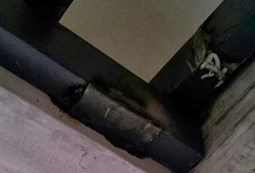

Those hollow steels don't seem to install to wall beams.
Can you show us some photos of how they bolt those hollow steels to the walls?
lyt25_1234
post Oct 1 2021, 10:11 PM
1,152 posts
Joined: Jul 2011
This is how my loteng is bolted to the wall beam with an L-steel bar which are then welded to the hollow steels.
