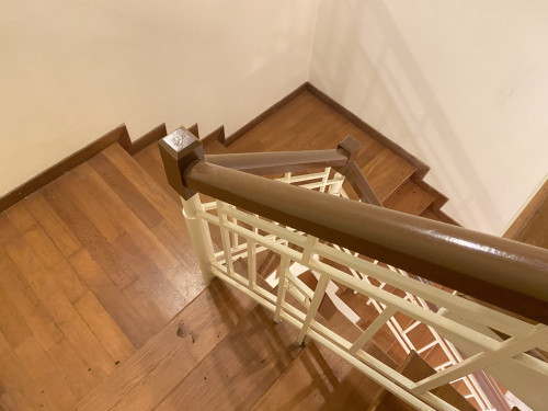

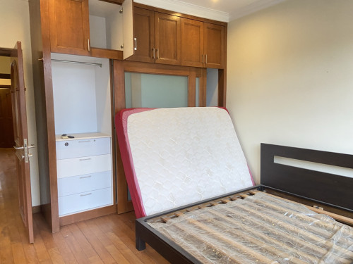

these are the pictures for reference!

by referring to the pictures, the flooring is real wood
1) the stair is mount under the flooring. the best method probably to cut the steel structure and cover the hole with wood filler (noticeable if see closely). Then your new stair probably need to avoid mount on the old points. For bigger portion, probably replace with another piece of wood.
2) it seems like there is wood flooring under the wardrobe. Highly depends on the skill and patience given during dismantling. Might have screws or nails but can be paste back with wood filler. it should be good if you plan to polish/re-coat the wood flooring afterward.

For the stairs, they can cut the frame and cover the holes with something. So not much damage to scrap all the flooring. Wardrobe seem only resting on the floor. Floor might not even damage underneath it. If turn bad might be moisture trap underneath wardrobe.

I see at the bottom of the railing looks like welding? Probably the railing is anchored to the cement on surface.
The floor is not laminated wood. They can just remove and replace with another piece only for the affected plank. I think it is not a big deal to repaint same color varnish.
The built-in cabinet is put on the floor after the flooring was done. I'm sure it can be dismantled without any problem at all. Will not damage flooring.

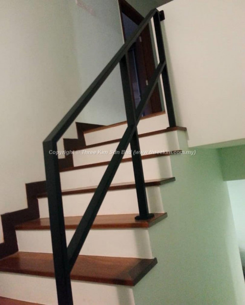

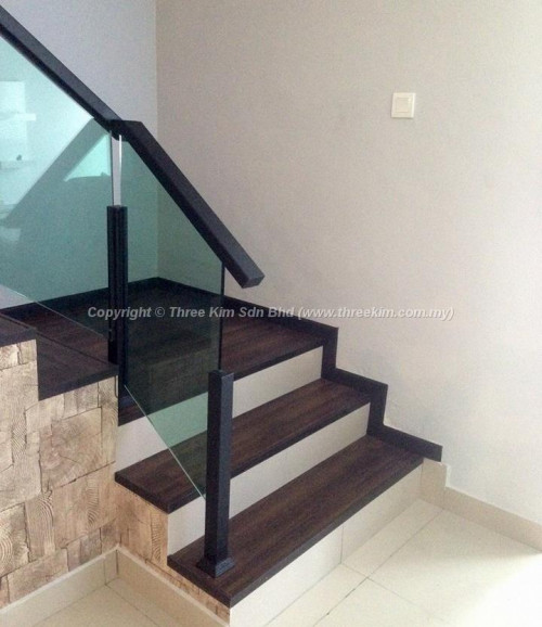

QUOTE(CanonLee @ Sep 27 2021, 12:12 PM)
Depending on budget, it's either going to be simple metal railing with only 2 bars (clean look) or modern glass look. These 2 pictures taken from threekim website, I see a lot forummers talking about there so I checked their website, haven't done actual research yet.
