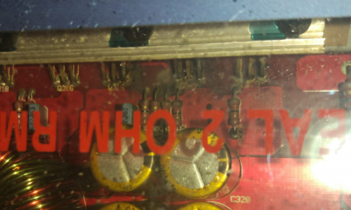

Leave the car not running around 4 months, now one of the amp is not turning off when HU is off, smell heavy burning smell after this happened and found some black soot on amp pcb board.
Wondering is it repairable or not, if not then is there any recommend 2ch amp is around rm400 budget? It's for mid and tweeter.

Buy new dsp amp

Thanks for the reply, finally I decide to bypass the fuse and install a switch for easy power on/off the amp so I can save the money on other things.

U can also hook-up a relay between the fuse connector and power source from USB or 12V. Plenty of such relay switch at Shopee.

Yeah I like your idea! Thank you!
