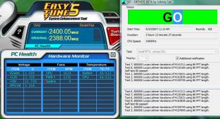

H all,
I undervolt my E6600 @ 2.4Ghz from stock 1.325V to 1.020V with temperature @ 44C full-load with room ambient @ 30C (CPU stress test with orthos > 2hr in progress w/o any error yet); Super PI gave me no impact on the performance. Btw, will undervolt cause any harm to the CPU or other components? Thks in advance~
This post has been edited by sotong168: Sep 10 2007, 01:35 PM

orthos should be able to test on the stablity right? thks~

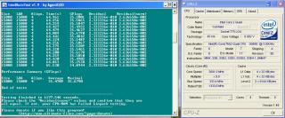

i did mine same as urs which is at 1.020V..but i also underclock mine as well from 2.4 till 1.9...
run steady...can play most of the games(oblivion,nba,fifa,C&C)....
temp i think is around 40+

It is best to test for stability when you undervolt and underclocked. I usually run orthos blend test for 6-12 hours at that underclock/undervolt setting. If it passes, then I would consider the rig 99.99% stable.... smile.gif

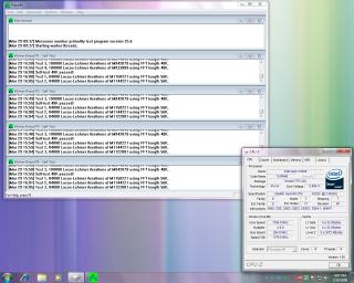

I undervolt my laptop. The laptop is now cool enough to be switched on 24/7 with folding@home, without laptop coolers. I think undervolting actually extends the life of the processor, instead of causing damage. I do prime95 for at least 6 hours to determine the lowest stable voltage.

My system have to be rock stable since I do folding@home. If it's unstable, folding will fail. I recommend running 2 instances of Prime95 to test for undervolting stablity.
