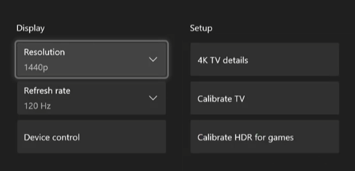

Anyone have series s or x using monitor can't get 1440p 144hz to work?
I can't get the resolution and refresh rate to work. only 1080p 144hz or 1440p 60hz. Monitor is Illegear bolt 27.
When I checked 144hz it will automatic kick me out of 1440p
anyone have same issue?

Xbox only support 120 fps, however I think the reason you only get 60hz on 1440p is because you are plugged in to the wrong HDMI port.
Your monitor have 3 HDMI ports, 2 of them are HDMI 1.4. You need to plug it in the HDMI 2.0 port.

ur monitor worked on 120fps? yep plugged in 2.0 hdmi no luck. won't work on 1440 120/144.

Yep 1440p/120 work on my Odyssey G5, maybe try using another HDMI cable
You probably tried these already
- Make sure you check the display overrides in "General Video" -> "Fidelity & overscan" is set to auto-detect.
- Don't allow 50hz (Setting can be found in "General Video" -> "Video Modes")
- Allow YCC 4:2:2 (Setting can be found in "General Video" -> "Video Modes")
- Turn off adaptive sync on your monitor

If I are to set "Fidelity & overscan" to auto detect. the refresh rate option would have not there.

Mine wan ok. Series S & Benq M28U. can 4k120 summore, cause res 4k is the only way Xbox can do HDR. dont ask why S not X, I'm waiting for Gears 6 LE Series X. already bought the expensive Seagate MMC & another 3TB ext storage cause ayam a data horder tongue.gif
maybe either monitor hdmi port isnt 2.0 or the hdmi cable not 2.0 & above. cause my dumb self thought the One X is a Series X when my new monitor arrive. I try to force it to do 4k120. lol it either kick it to 4k60fps or 1440p120fps. took me awhile to notice One X hdmi is 2.0 not 2.1. ayam stupid bangwall.gif

Im using Illegear Bolt 27. yes, I tried on Series X and it not support 1440/120fps on that monitor sad.gif
That monitor only support 120/144hz via Display port. I tried HDMI to DP adapter too. its not working.
Next time when buy a monitor need to check the specs carefully the refresh rate via DP or HDMI or both.
I believe other brands like Prism, Titan Army also same like Illegear.
my cousin bought ASUS VG27AQ works on SX 1440/120.
