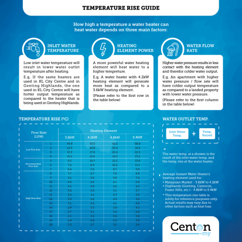

3 factors that affects your output water temperature:
1. Water Heater's Heating Element - The higher the number, the hotter the output. Market most common ones are 3.6kW to 3.8kW. Besides these common ones, Joven has a 5.2kW model, Centon has 4.2kW and 5.4kW.
2. Input Water Temperature - The lower the input temperature, the lower the output temperature. Hence why raining season your output water is colder.
3. Water Flow - The faster the water flow, the lower the output temperature, because lesser contact time between heating element and input water flow. Hence why condos which high water flow (strong water pump) should use at least 4.2kW.
Got this table from Centon's website, u can refer to this, what kind of temperature rise (output - input temperature) you can expect with the heating element you are using, factoring in the water flow rate.
Hope this helps!
Hope this helps!
