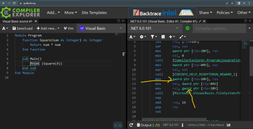

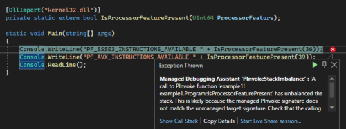

FlierMate1
post Jul 9 2022, 09:05 PM
Validating
139 posts
Joined: Jun 2022
QUOTE(CPURanger @ Jul 8 2022, 09:42 PM)
Turn off optimize flag when compiling C#, may show a different results.
Thanks for your nice comment. There is no compiler option has been set, so I tried Visual Basic (also .NET compiler) and see, and the Assembly output is much longer than C#, for the same purpose.
Surprisingly, I found a bug in the compiler's Assembly output. Notice the "gword ptr" at line 12 and line 14?
Update: It is not a bug. See: https://github.com/dotnet/runtime/blob/11f2.../instr.cpp#L199
This post has been edited by FlierMate1: Jul 9 2022, 09:14 PM

Has anyone heard of "Stack Imbalance"?
I encounter "PInvokeStackImbalance" error message when accidentally upsize the width of parameter to IsProcessorFeaturePresent Win32 API function in kernel32.dll
CODE
BOOL IsProcessorFeaturePresent(
[in] DWORD ProcessorFeature
As shown in the syntax above as outlined by https://learn.microsoft.com/en-us/windows/w...rectedfrom=MSDN , ProcessorFeature parameter is DWORD 32-bit in size.
What I did was specify the parameter size as UInt64 (unsigned integer 64-bit) in C# .NET:
CODE
[DllImport("kernel32.dll")]
       private static extern bool IsProcessorFeaturePresent(UInt64 ProcessorFeature);
(The correct data type is "uint" which is 32-bit unsigned integer)
You can notice in the screenshot, I got this nice error message:
QUOTE
Managed Debugging Assistant 'PInvokeStackImbalance'
  Message=Managed Debugging Assistant 'PInvokeStackImbalance' : 'A call to PInvoke function 'example1!example1.Program::IsProcessorFeaturePresent' has unbalanced the stack. This is likely because the managed PInvoke signature does not match the unmanaged target signature. Check that the calling convention and parameters of the PInvoke signature match the target unmanaged signature.'
I understand that in Assembly, I might have pushed another DWORD (and thus QWORD) onto the stack, like this?
CODE
cpufeature dd 39
   push [cpufeature]
   push [cpufeature];extra push (cpufeature != dq)
   call [IsProcessorFeaturePresent]
So it caused the stack to misaligned, but isn't it a nice way to say, "....has unbalanced the stack".
What's your thoughts? Are you new to this term "stack imbalance"?
Corrections:
QUOTE
Stack imbalance == mismatched push-to-pop ratio. So the stack either keeps growing, or keep shrinking.
It is different from misaligned.
Misaligned = Addresses don't have the lowest bits as zero.
This post has been edited by FlierMate4: Feb 4 2023, 10:34 PM
