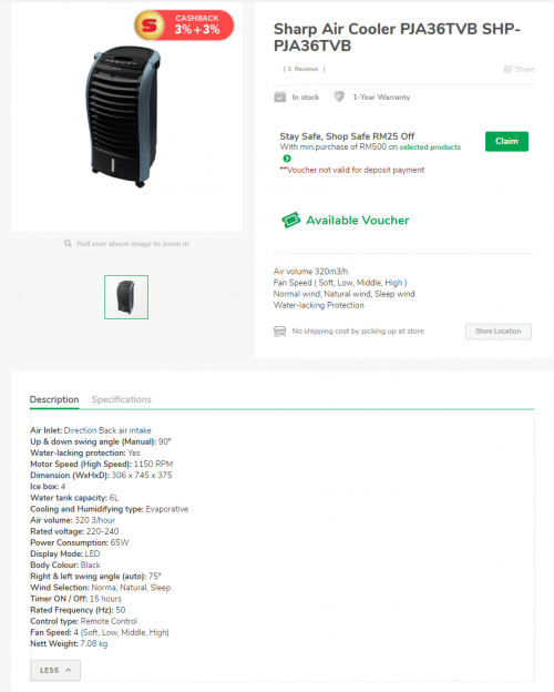

Anyone here using/used air-cooler? Mind if I ask for your feedback? I just googled some info, so far I got is:
- capable of reducing "wet bulb temperature" by 3-4 'C although I have no understanding on the wet bulb temperature part as it involves humidity reading (any sifus care to explain the term?)
- saves electricity cost vs air-cond by at least 1/4th ( but I think can't compare with air-cond as it can bring down the temperature to a targeted reading)
- from my understanding, getting a >130watt power consumption unit is most effective in doing the task?
I'm keeping an eye on this device and got me thinking " If i get it, I can reduce the air-cond usage and maybe reduce the overall electricity consumption in the long run? like this thing can also replace a fan right?
