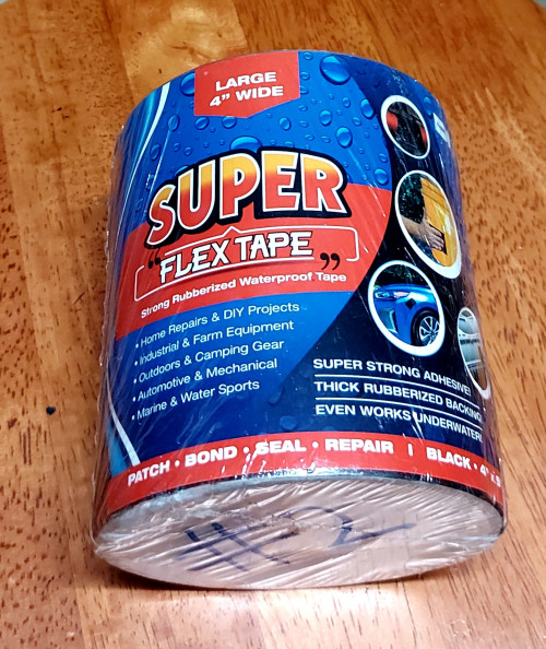

Use those sticky tape for water leak. I dun think silicon can be use to seal it

Can share example of sticky tape? Duck tape?

waterproof tape.
from Mr. DIY.
under rm15.
after cleaning the area of rust n debris, apply one layer top n bottom to cover holes.
not a permanent solution, but it's quick n cheap.

Go diy shop buy those Bitumen tape.

Clear silicon gives a neater and clean sight after repair. Injection of silicon goes deep into the fine crack.
Nevertheless, tapes can also be use.
