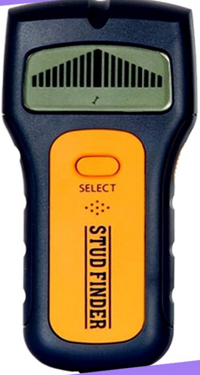

Hi Peeps, I'm planning to do some Drilling works in my house. But I'm afraid of spoil the Pipe or Wires under the Wall.
I came across there is such a tool so called Stud Finder (Wall Detector)
Anyone experienced this before? How reliable is this product to detect the things under the wall?

most cheaper 1 cannot detect water pipe (because our water pipe usually pvc)
bosch 1 that can detect is not cheap (e.g. d-tech 120 cost around myr 800)

The one from Bosch is like RM800.00
Those ciplak brands are like RM50.00 only
The difference is too big. So I'm wondering how effective is this.
Yup, I noticed that too, Those Ciplak brands are like RM50.00 only
The difference is too big. So I'm wondering how effective is that.
