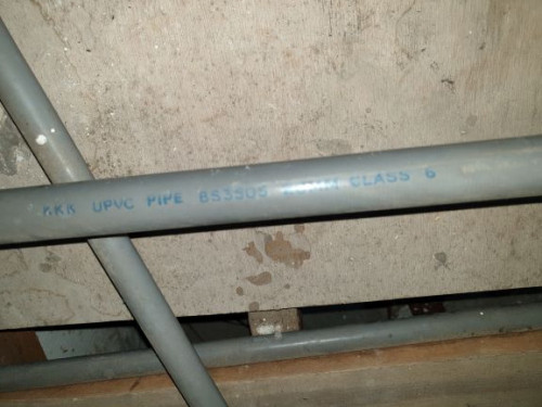

for the existing uPVC : it's labelled KKK UPVC PIPE BS3505 20mm Class 6
- is uPVC and PVC the same thing? I read it’s different, but in Malaysia context seems to be similar)pic below

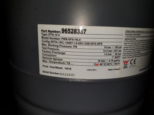

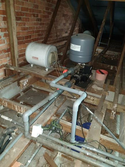

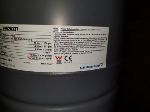

existing 7 year old grundfos - replace? or keep till broken?

May want to see if you can relocate the 13A SSO for the pump to a higher mounting spot (away and above from the water pipe, where reasonably practical, if possible), coz putting anything below water pipe is also risky if it leaks - as you won't be climbing up everyday to inspect.
