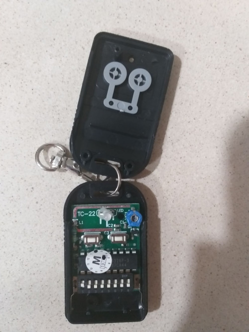

SUSmac60931
post May 10 2021, 04:01 AM
Joined: Jan 2019
QUOTE(rtk74 @ May 10 2021, 03:56 AM)
This but to confirm, just open up your remote and look at the writing on the metallic pill shape on the board
See the numbering metalic chip casing beside the upper button? This one says R330. TS, yours should be 433. biggrin.gif
This post has been edited by mac60931: May 10 2021, 04:02 AM

adamgombak
post Aug 28 2022, 10:43 PM
16 posts
Joined: Jul 2008
QUOTE(mac60931 @ May 10 2021, 04:01 AM)
Mine don't have the numbering metalic chip.
I bought a 433mhz remote control as a spare from shopee.
Set the same dip switch but it's not working with my autogate. What's wrong?
pandah
post Aug 17 2023, 01:02 PM
719 posts
Joined: Jul 2011
QUOTE(adamgombak @ Aug 28 2022, 10:43 PM)
sorry korek thread lama, i have an remote like the above as well, it there anyway to tell if it is 330 or 433mhz?
