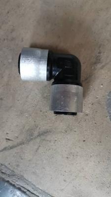

There's a current leak in my the ceiling pipe. (Please see video - https://streamable.com/riewp3
Plumber said to that this kind of piping is not used anymore and has recommended another type of piping (picture below/attached).
Could you please take a look and let me know if this is suitable and is the right way to fix the leaking problem?
He has quoted me RM500 to replace the entire piping in the video(materials + workmanship)...
Really appreciate guidance on this so i dont kena chop

What plumber suggests look like Buteline fittings.
Actually it seems to be upselling lah but if want to do minimal fixing can just change the leaking fittings or add new HDPE pipe as necessary.. the material cost not expensive lah.. the headache is just to get ppl to climb up only.. CSM hardware sell all sort of this HDPE fittings.

Since its user accessible without destroying plaster ceiling then can just go w usual HDPE fittings. It can last many years if done right. Buteline is for really fire and forget use case where you dont wanna hack tiles for in wall concealed piping..but pricey.
HDPE is pretty reliable like a Scania container lorry already and will be around for many years.. buteline for those who really need a bulletproof tank and where redoing the pipe is a tough job primarily due to concealment and/or expensive rework use case.

If I am not mistaken it looks like the equal T is the source of the leak and not the end L (elbow) - you just need the tee (Hansen fitting i.e. the screw compresses the pipe to be a tight joint) like this one : https://shopee.com.my/-1-UNIT-Hansen-FITTIN...9814.7777640272
The only thing I can't tell from the video is whether you need a 20mm or 25mm or 32mm size. hmm.gif
It will be marked on the Tee joint as 20 25 or 32.
Can use a piece of paper wrapped around the pipe and mark where they end up to get the outer circumference - can calculate OD (outer diameter) from there using the circumference/π and test wrap on the fittings at the shop.
Should be pretty simple. All black (HDPE) fittings will be on its own section. CSM 225 has a whole aisle for pipe fittings.
