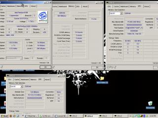

i did it on my ram last time..then in cpu-z it shows 500mhz..my ram only 133mhz..

QUOTE(dj.eRicZzz @ Sep 25 2007, 03:23 PM)
huh?
care to share how to do it anot?
dj.eRicZzz
post Sep 26 2007, 04:45 PM
Diet plan, TOMORROW!
1,701 posts
Joined: Jul 2006
From: Malaysia
i just use a 2b pencil and colour the gold part...

first thing...pencil mod on the rams itself is just not worth doing...no gain at all. The mod only mess with the Eeprom of the ram to make show higher speed ram.
