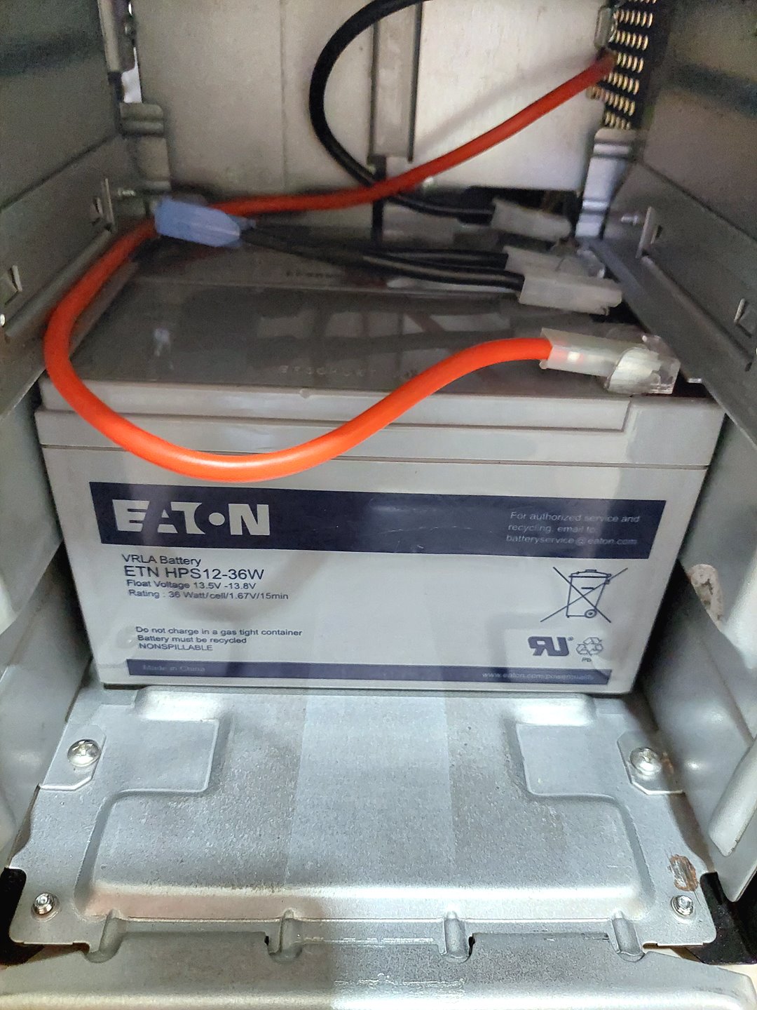

May i know if there is any cheap SLA battery to replace APC RBC#6 battery?
The ori battery no spec and it comes in two SLA connected in series so i assume each 12V?
I just want to test the UPS if it is still working or not. The ori battery dah kaput. Thank you.

hi…thanks for sharing appreciate that.
so i need buy two and connect it like original to replace the rbc#6 right?
so the original rbc#6 is 24v because two 12v SLA battery connected series?

yerp, it just being connected via that middle cable

thanks again for the recommendation.
received the batteries and working fine now.
the seller is nice too, he recommends if know how to do parallel connection then can connect more batteries to extend the runtime.

ya, the UPS is still functioning. just that the old battery bloated, leaked and corroded the inner of the casing (u can see from the picture)
should have taken out the battery and dispose it before putting the UPS in store room for years sweat.gif
