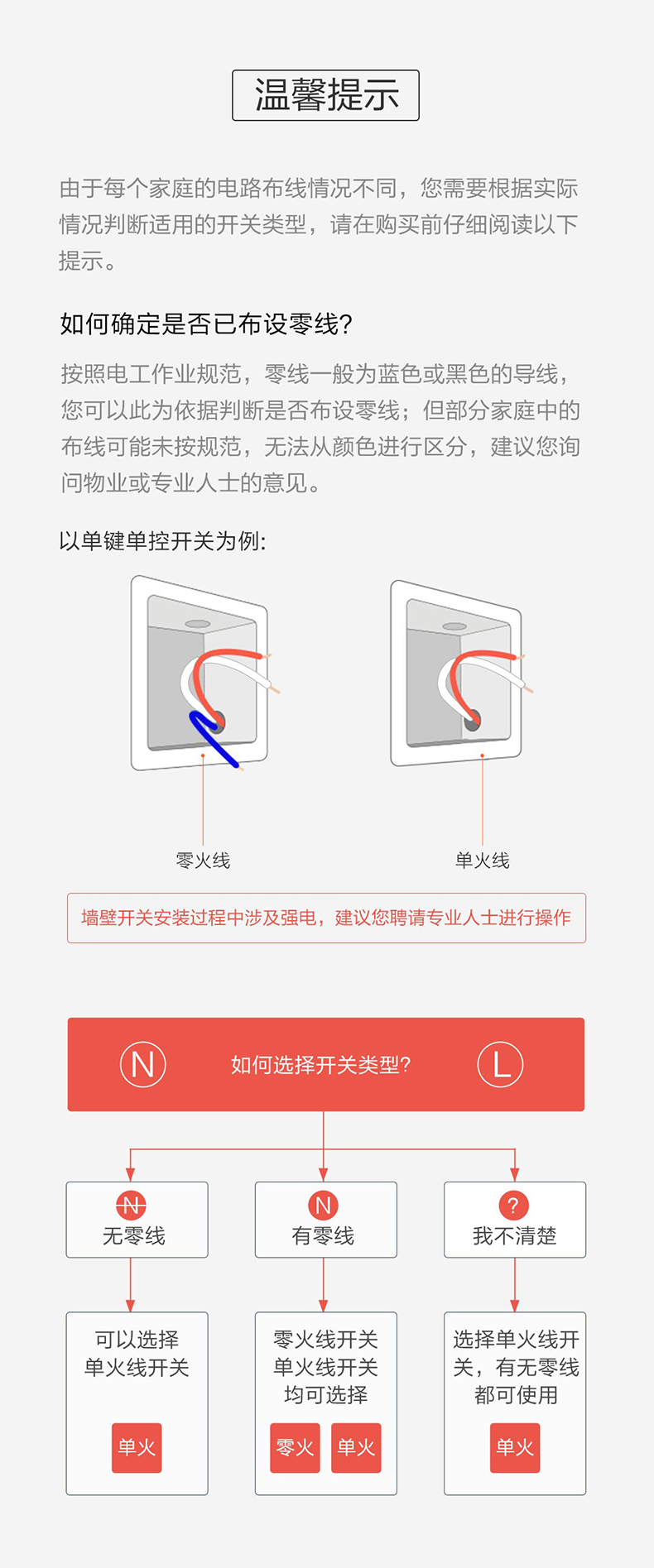

1. Can but get the no neutral type (single fire wire). Unless you get your wireman to put in a neutral line at all your switch point. With neutral line is better.
