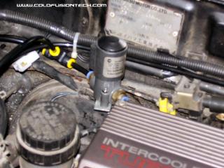

coldfusionpower
post Aug 28 2007, 12:42 PM
My Cat Like To Shoot Noobs
3,158 posts
Joined: Jun 2005
From: Planet Earth
i had this 2 years ago . but i add methanol to the water. 50% water and 50% methanol . running 18psi of boost with this . using a 60psi shurflo water pump , controlled by a 12v DC water solenoid and injected tru a brass nozzle just right before the throttle body .
Attached Image Attached Image
anyone tried CO2 cooler ? abit similar ..
CO2 Tank --> Nitrous Solenoid --> Nitrous Nozzle ... simple as that .
