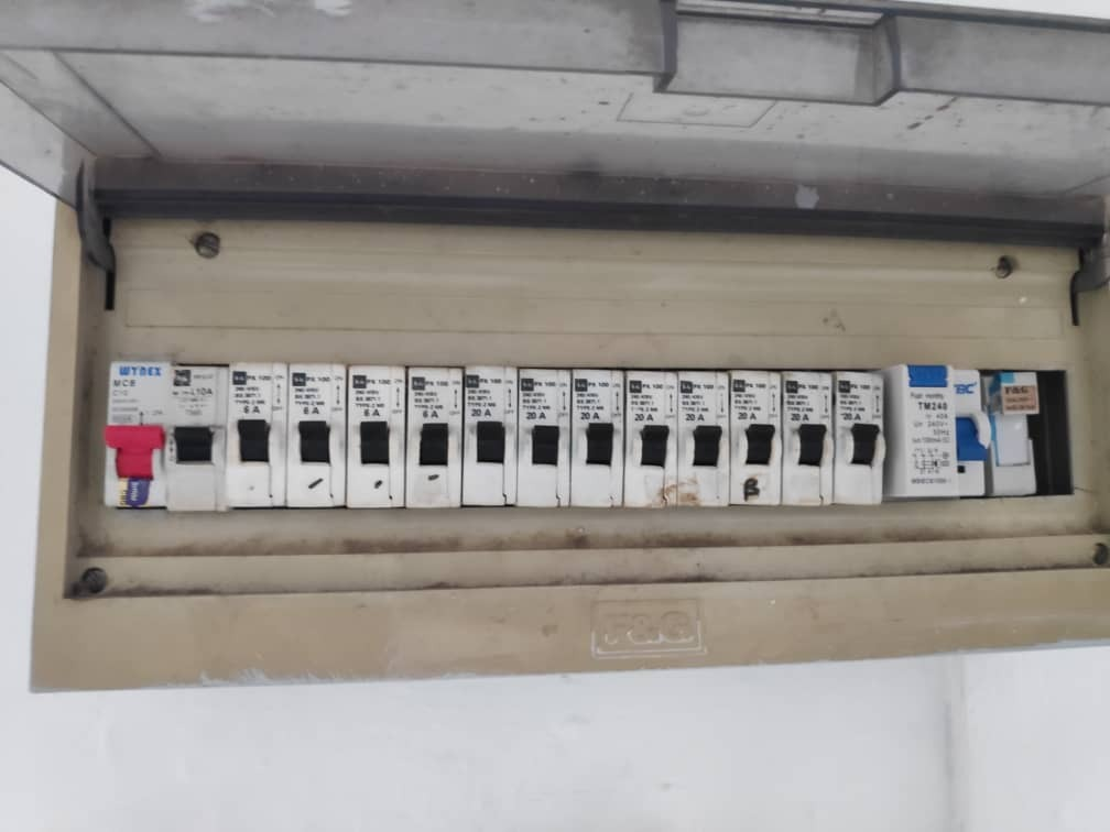

CONSIDERATIONS WHY YOU NEED 3PH (OR NOT)
3 phase power if you're running a lot of AC (>4) and electric instant WH (easily 16A each) and heavy kitchen appliances (oven kettle ricecooker slowcooker) simultaneously, else if existing 1ph 63A should suffice.
This will need additional TNB deposit to upgrade, submit at TNB, then change meter to 3ph, and you will need DB box upgrades on main switch to 3P, main RCD to 3P+N, main MCCB for 3ph. Probably need a new DB box since 1ph box itself is rather small to fit all these additional module (they take up 7-10 slots, 7 if skip main switch, even before counting the single MCB breakers)
REGARDLESS OF 3PH OR NOT, REFRESH THE DB BOX FOR FIRE SAFETY AND LIFE PROTECTION
A complete DB refresh will be recommended since its already >30 years old meaning the (then prevailing standards) also changed since then for safety.
Also >30 years stuff is time to change as they lose spring tension etc.
Can post a pic for better commentary as (if it has not been refreshed) it could still be using very dangerous high limit RCDs like 300mA - which don't save lives, it only prevents house from burning down. By the time it trip in fault operation - it has killed a human 6 times over (50mA is all it takes).
Parts wise maybe around 600-700 bucks if all top tier stuff inside (ABB Hager Schneider).

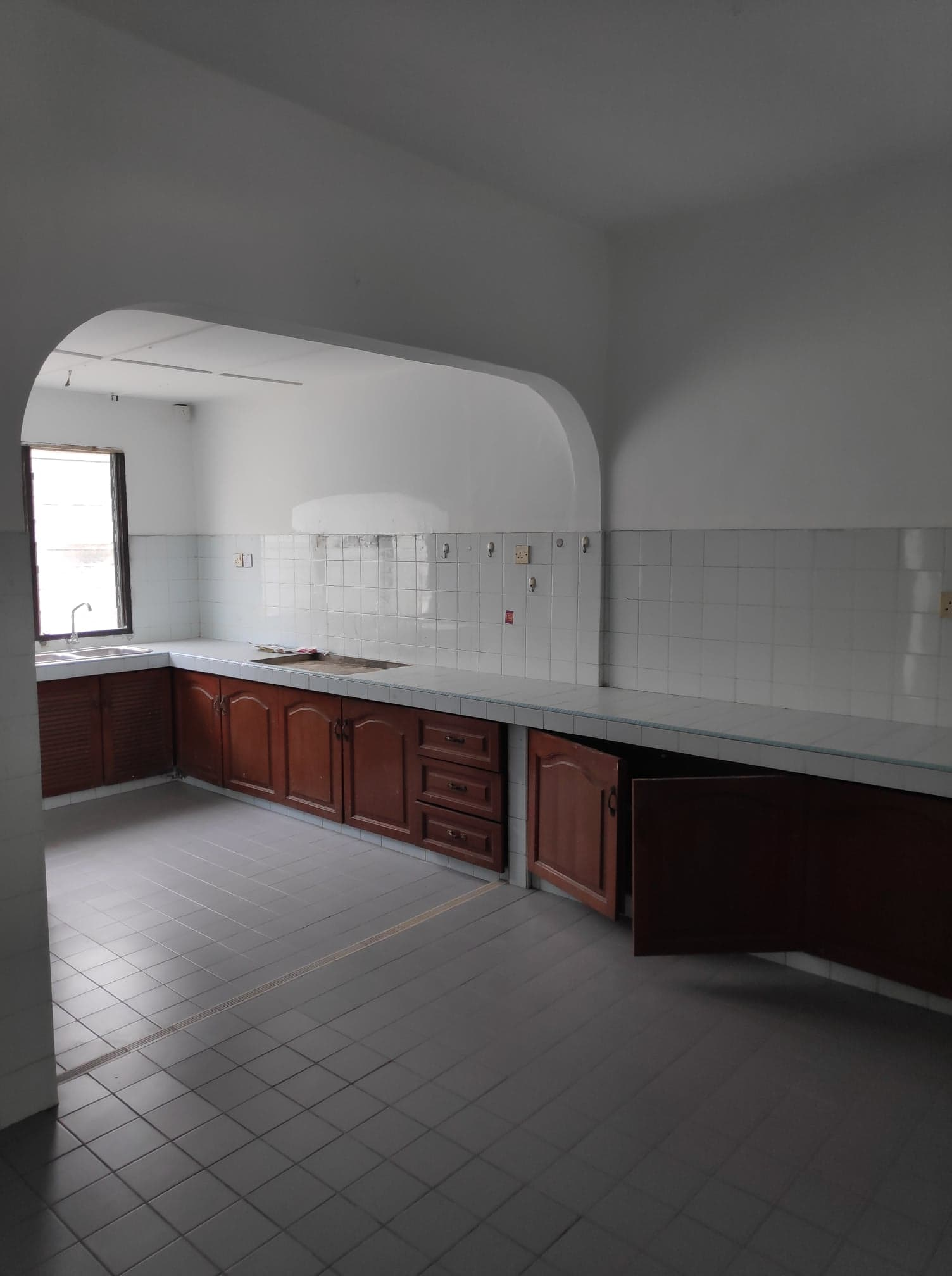

2. Redo the existing tiles on the kitchen counter top spanning about 8 meters.
get a good quality tiles, you can opt for 60mmx120mm
3. Replacing kitchen cabinet to something more durable, perhaps aluminum cabinets?
aluminium is very much expensive, you may opt for wood for wall units

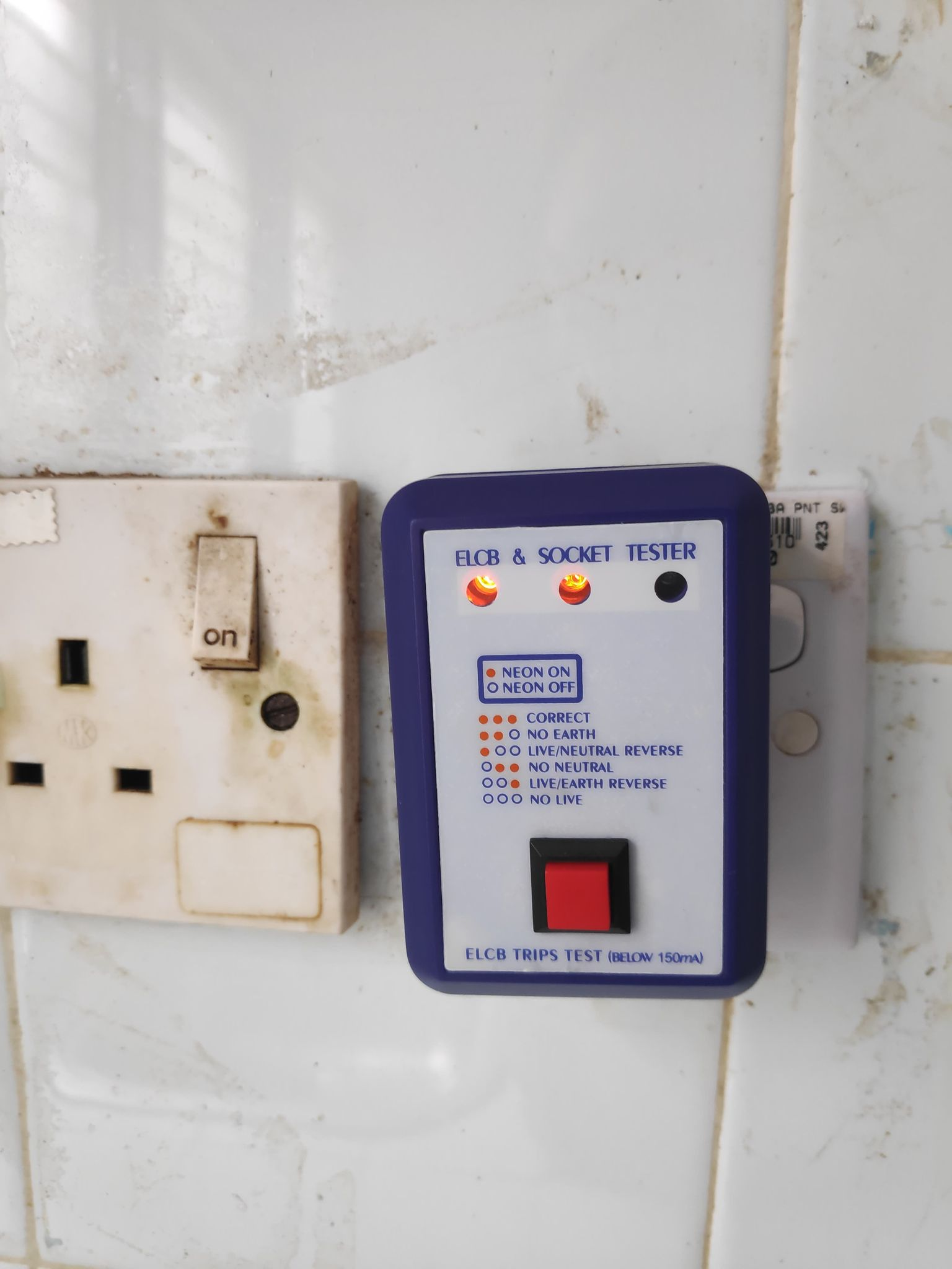

Thanks for the advise on 3ph. I guess I won't be needing it after all. I don't see myself using that many water heaters and ACs simultaneously. hmm.gif
Definitely will need to replace the whole DB and the components within. The current ELCB is rated for 100mA. Gotta add in more MCCB and get a 10mA for the water heater as per your suggestion. Here is a pic of the current DB.
I have been considering for the major rewiring mainly because I noticed some of the sockets within the house is not connected to earth. doh.gif
And... 1V of voltage leakage, not sure if this is something to be concerned of hmm.gif
Good sharing on the water heater electrocution. Definitely get that 10mA MCCB. biggrin.gif
I have also been watching the Youtube videos of MAH Bayu Enginering and learning on these stuff so that I make sure I don't cut corners when it comes to these. Anyone tried their works?

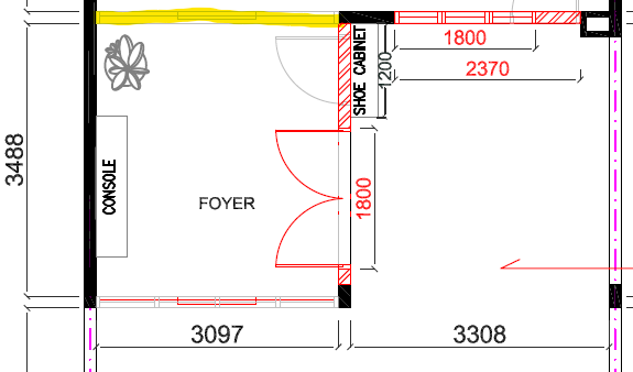

6. Demolishing a "Partition Wall" extended front section of the house and new door.
double check the developer drawing (if available) to avoid structure damage.
@Reply: I am contemplating whether I should demolish and flatten it out as per the image's yellow highlight, or follow the interior designer's idea or just extend both sides all the way out. I guess I will still have to look at my budget....
@Reply: This is the current state of the kitchen counter and cabinets. In the worst case scenario, I will just change the hinges and use them for the time being.  rclxub.gif

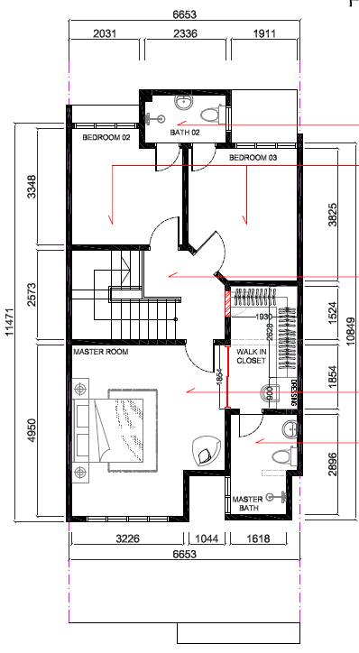

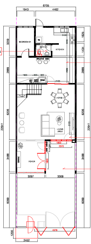

If can provide layout and size better for advise. My Reno almost done for a single storey which is also 30years at klang valley
Just saw ur size same as mine.
Here is a layout by one of the ID I consulted for reference.

Typically WH (current model Pana) rated at 3600W, so /230V = 15.65A
There are some WH (Toshiba) rated at 3800W, = 16.52A
Yes, for the MCBs they're not that expensive (RM8 per piece for top tier) but would recommend to take all from same brand,
even though all of them can mount onto the mounting DIN rail,
physical tolerances and busbar mounting hole between brands can and do vary.
As the busbar (live rail) is just a copper bar, rather inflexible mixing brands can cause loose contact.
The individual big blocks (RCDs and main switch and main MCB) which are connected by cables rather than busbars are not affected, although sometimes it is nicer all same brand so can directly plug the busbar into WH RCD input as well.
RCD 30ma Full house protection (change light bulb, plug in socket, etc all protected)
ABB FH202 63A 2P 30mA - 139 per house m/in Italy
Hager 63A / 2P 30mA - 143 per house, m/in France
Schneider Easy9 63A 2 Pole 30mA - 123 per house, m/in PRC
RCD 10mA per each WH (ST Regulation)
ABB 25A / 2P 10mA RCCB - 179 per WH, m/in Italy
Hager 25A/ 10mA RCCB - 168 per WH, m/in France
Schneider Easy9 25A 2 Pole 10mA RCCB - 105 per WH, m/in PRC
MCB (time to change as some seem like no SIRIM, also not good practice to mix 3 diff brands for abovementioned reason)
ABB SH201 1P MCB 6KA - 8.50/pc
hager MU Series 1 POLE MCB 6KA - 13.50/pc rclxub.gif
Schneider Easy9 1 Pole MCB 6kA - 9.20/pc
TCO (total cost of ownership) not that much difference between the three top tier brands (easily obtainable in MY);
shortlist ABB and Hager because their RCDs all made in EU (rather than PRC);
but because Hager MCB very expensive (it adds up)
end up I still stick with full DB box of ABB myself.
If just want a basic refresh of 13A sockets, MK S2757 (frameless) is quite a good solid choice. Framed type always tend to pop off if not glued down.
The socket tester give error, is because the insides already gone - (if you open up the socket) and (based on the mounting screw already rusty) one can imagine how badly the inner nut box (back box in the wall) already rusted through. laugh.gif
That metal back box is very dino technology. 30 years ago, and now, also still selling the same old thing.

your kitchen cabinet's doors seems ok-ish condition. Might just need to re-paint the door and change the hinges. Remove the door before hacking of existing countertop tiles. the carcass probably unable to restore. Anyway the length is so long!
