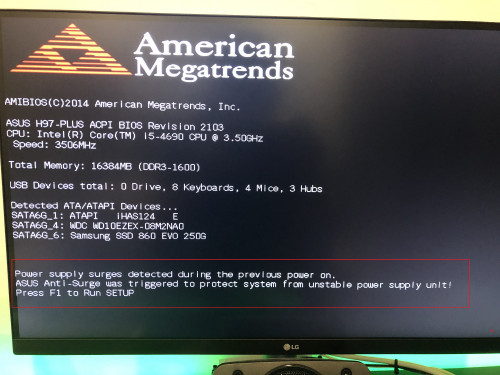

sometime playing dota 2 around 1 and 2 hour suddenly restart pc and come out this error , what is the problem? after restart pc , pc still working fine
power supply surges detected (help)

PSU dying. Replace it.

QUOTE(2chuangliang @ Feb 17 2021, 09:54 AM) sometime playing dota 2 around 1 and 2 hour suddenly restart pc and come out this error , what is the problem? after restart pc , pc still working fine I had the EXACT same issue with my Corsair RM750i. My RM750i, being "i" model, i can monitor PSU realtime current draw, volts and internal Temp. After plaguing me for 1 month, and countless troubleshooting on my part, turns out that the cause is my PSU Overheated during heavy gameplay, and The PSU shutdown to protect itself, but the effect is my Asus MOBO detected as power surge, just like TS! Turns out when i set the PSU FAN to start automatically when under load (zero speed at light loads), fan starts ONLY at high load, not moderate load. Temp protection kick in at 50degC (slightly low, design issue, corrected in next gen), but at moderate load my temp already hovering at 46 degC (PSU placement and orientation issue). So a few minutes into game, will get surge protection fault in BIOS on a hot day, but less occurrence on cold nights. After i set the fan to run at 40degC even when no load, then ramp to 100% at 48DegC, no issue even when gaming at 550W for the whole day. This post has been edited by BelaCHAN: Feb 17 2021, 10:30 AM |

QUOTE(2chuangliang @ Feb 17 2021, 09:54 AM) [url=https://pictr.com/image/7FDU7Y] So TS, if your PSU is more than 5 years old, replace it.sometime playing dota 2 around 1 and 2 hour suddenly restart pc and come out this error , what is the problem? after restart pc , pc still working fine If its new, try to keep it cool by increasing PSU fan speed if possible. if not then change PSU orientation, or generally keep CPU internal air temp low by reconfiguring intake and exhaust fans, such that when PSU fan exhausting air from your case, lower case air temp can cool PSU more. First world problem arguably, but hope it helps. This post has been edited by BelaCHAN: Feb 17 2021, 10:35 AM |
