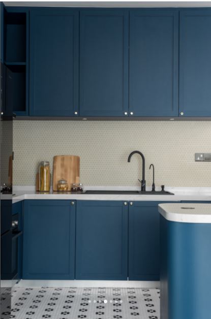

what is the name and model ? those are really small tiles ? does it come in combined pieces rather than individual tiny pieces ?
for kitchen flooring
for kitchen backsplash
what is this tiles and where to get it ?, kitchen floor and backsplash

Mostly its called subway tiles/decorative tile
https://shopee.com.my/180-pcs-Imported-Whit...6084.3377882069 for flooring I think usually use mosaic tile. but technical porcelain better for high load (hardwearing and consistency) https://shopee.com.my/180-pcs-Imported-Whit...6084.3377882069 https://www.homa2u.com/material/floor-wall-...or-tiles?page=9 https://www.mymml.com/collection-type/technical-porcelain/ these are crème de la crème.. top grade stuff for floor |

For TS's kitchen floor, that should be called Artisan/Moroccan tiles instead of subway tiles.
But in Malaysia, most of these tiles are meant for wall instead of floor. For TS's kitchen backsplash, the picture is too small and blur. No comment. QUOTE(Pain4UrsinZ @ Jan 29 2021, 12:23 AM) does it come in combined pieces rather than individual tiny pieces ? Depends on the type and size.If it is mosaic, then it's normally in "combined" form. |

QUOTE(Snoy @ Jan 29 2021, 09:16 AM) For TS's kitchen floor, that should be called Artisan/Moroccan tiles instead of subway tiles. thank you .i upload the design againBut in Malaysia, most of these tiles are meant for wall instead of floor. For TS's kitchen backsplash, the picture is too small and blur. No comment. Depends on the type and size. If it is mosaic, then it's normally in "combined" form. ![]() |

QUOTE(Pain4UrsinZ @ Jan 29 2021, 09:53 AM) Won't be slippery because it is consists of multiple small pieces like mosaic.Similar design for your floor: https://www.homa2u.com/material/floor-wall-...es-ZL-Hexagon-2 I'm hesitating if your backsplash is tiles or vinyl sticker. Anyway, something similar: https://www.homa2u.com/material/floor-wall-...es-ARK01-50100G |

QUOTE(Snoy @ Jan 29 2021, 10:41 AM) Won't be slippery because it is consists of multiple small pieces like mosaic. hmm if vinyl sticker is available then much better so i need to to remove the existing tiles. do we have such thing in vinyl sticker ?Similar design for your floor: https://www.homa2u.com/material/floor-wall-...es-ZL-Hexagon-2 I'm hesitating if your backsplash is tiles or vinyl sticker. Anyway, something similar: https://www.homa2u.com/material/floor-wall-...es-ARK01-50100G |

QUOTE(Pain4UrsinZ @ Jan 29 2021, 11:12 AM) hmm if vinyl sticker is available then much better so i need to to remove the existing tiles. do we have such thing in vinyl sticker ? In my opinion, sticker will look good with camera but not in reality.If there is existing underlying tiles, it will be worse to have uneven finish. If you still want to look for sticker, please check out lazada or shopee. |

For Asian kitchen and any other high traffic areas, you want to get the toughest tiles available which is technical porcelain tiles. All these cutesy homogenous tiles or stickers will let u look fine for a few months before they will deteriorates. Decorative tiles are suitable for walls but not very practical for floors ceo684 liked this post

QUOTE(kuchaikway @ Jan 29 2021, 06:48 PM) For Asian kitchen and any other high traffic areas, you want to get the toughest tiles available which is technical porcelain tiles. All these cutesy homogenous tiles or stickers will let u look fine for a few months before they will deteriorates. Decorative tiles are suitable for walls but not very practical for floors Agree...Wall is okay.. Floor better get heavy duty one.... And Malaysia weather.... Those "fancy" one not really suitable.... |

QUOTE(kuchaikway @ Jan 29 2021, 06:48 PM) For Asian kitchen and any other high traffic areas, you want to get the toughest tiles available which is technical porcelain tiles. All these cutesy homogenous tiles or stickers will let u look fine for a few months before they will deteriorates. Decorative tiles are suitable for walls but not very practical for floors QUOTE(nexona88 @ Jan 29 2021, 08:42 PM) Agree... There are also nice homogeneous porcelain tiles.Wall is okay.. Floor better get heavy duty one.... And Malaysia weather.... Those "fancy" one not really suitable.... Please check the links above. Furthermore, when they are smaller size, they are less prone to crack and pop than the bigger size brothers. |

QUOTE(Snoy @ Jan 29 2021, 05:04 PM) In my opinion, sticker will look good with camera but not in reality. Sticker in high heat area like behind stove may not be a great idea. May be fire risk as most of these are not fire rated.If there is existing underlying tiles, it will be worse to have uneven finish. If you still want to look for sticker, please check out lazada or shopee. |
