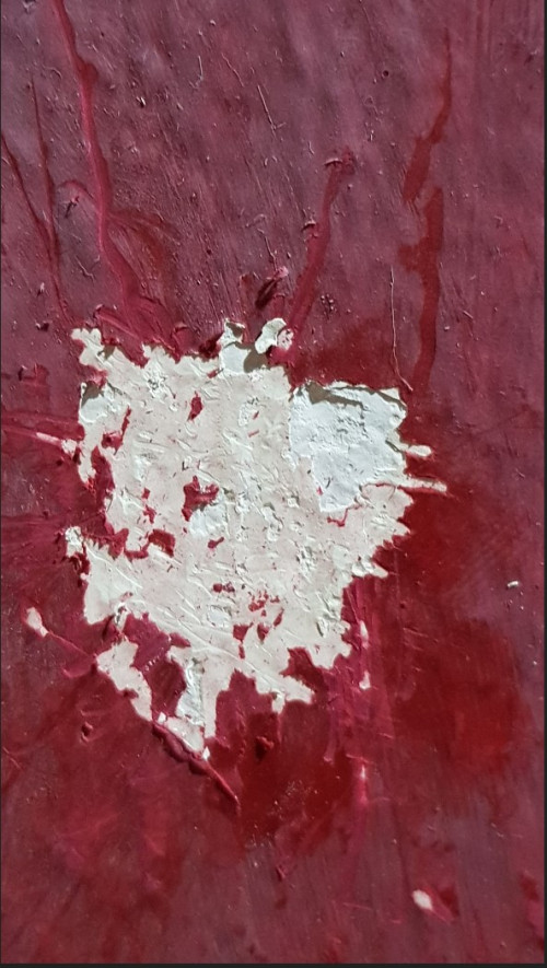

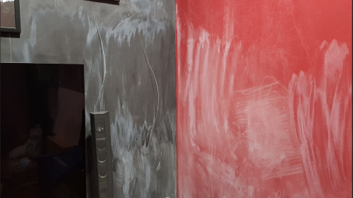

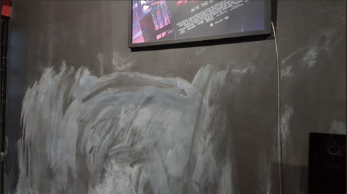

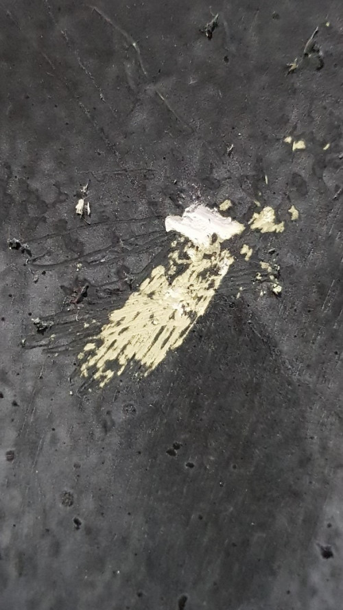

Paid painters to repaint my room about a year ago, after a few months the white 'stains' started appearing.
I wasn't home and my parents were kind of overseeing the job, but they can't confirm if the painters actually primed the walls. They did tell me that the painters had to do a lot of coats, about 5-6 coats to get the colors on the wall. After scraping it a bit, the previous color is underneath the new paint so I think they painted over them.
It's all over my room and I can't seem to get rid of them through normal means.
Paint used is Dulux Pentalite
Does anyone know what is the cause and solution?

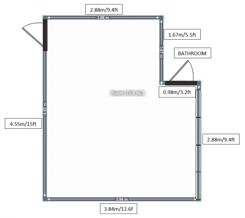

This is my room. Windows on the right wall.

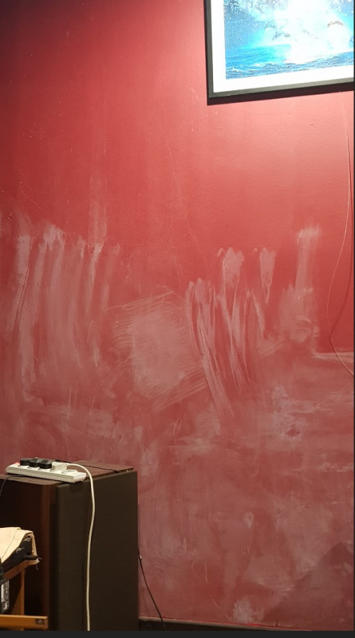

The walls feels pretty dry, including the white buildup, almost powdery like if I wipe with my fingers.
By plaster sound you mean hollow sound? Sounds solid when knocked.
For more context, the buildup somehow occurs mostly on the lower half of the walls. When it first started I did wipe with wet cloth, which will remove the buildup, but reappear after awhile.
