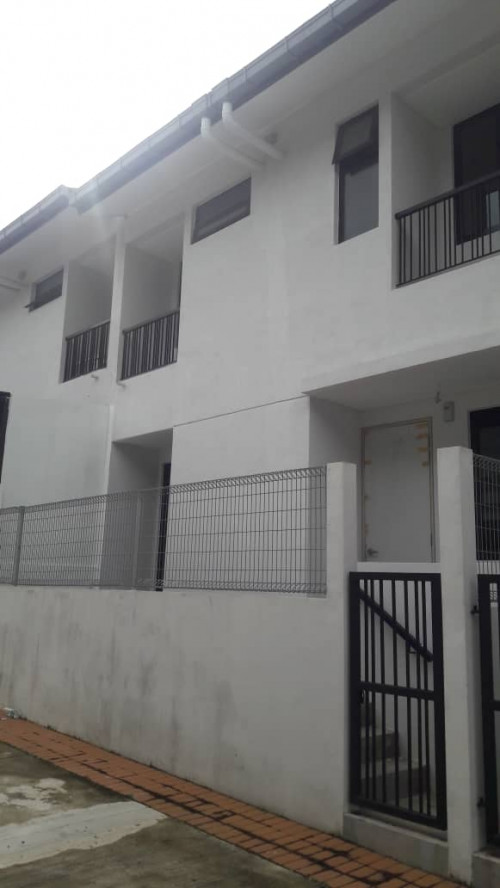

Location: Elmina Valley 4, Seksyen U15 Shah Alam
5ft out, walls up the sides, tile the floor.
I actually have the floor and wall tiles already.

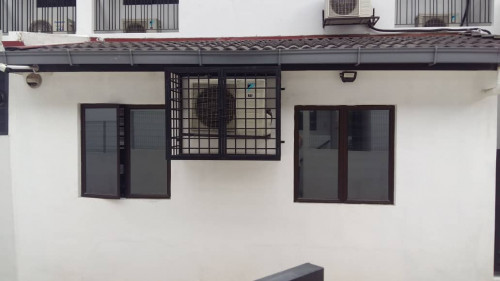

Current site condition, *sorry need to borrow other people's iamge, but it's exactly the same.

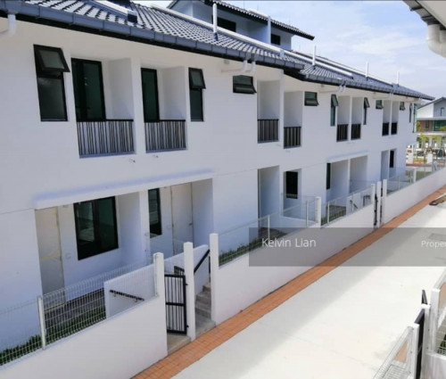

End result should look something like this? (without aircond box and roof pitch should be higher)
