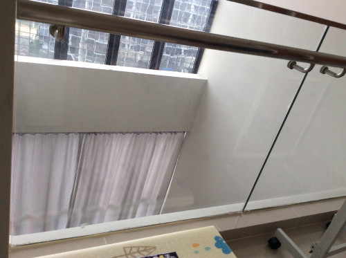

1.How much cost need to build wooden floor with room size about 10x10 ft?
2.this is inside my condo, do this allowed?
https://pictr.com/images/2021/01/17/7TpChU.md.jpg

(1) do you mean this?
wooden floor on wall??
or wooden floor (laminate/flooring) on top of the floor tile?
(2) what exactly is allowed? mini curtain? xtend barre bar?

i think she/he wants a complete wooden floor to extend the loft space laugh.gif

I would worry more about support

You’re correct. I also worried about the support.
Looking for opinion and right contractor.

Framing using 2x3 or 2x4 wood planks will ensure adequate or overspec support for a carload of ppl.
