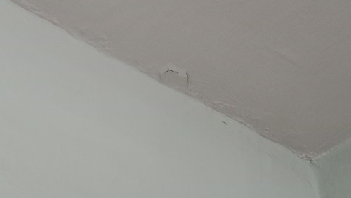

https://pictr.com/images/2022/12/27/EUZCvq.md.jpg
This tiny one in the bedroom, I can patch it myself? Putty, white cement or Davco? |

QUOTE(Zitrone @ Dec 27 2022, 10:58 AM) <a href='https://pictr.com/images/2022/12/27/EUZCvq.md.jpg' target='_blank'>https://pictr.com/images/2022/12/27/EUZCvq.md.jpg </a> scrap out all the surrounding paint, and any loose plaster, beginner can use putty if the patch of plaster that came out is not too thick (< 5mm). apply in thin layers as the first layer will likely have cracks after it dries. sponge it with a car wash hard sponge that is just damp to smoothen it and conceal any fine cracks after.This tiny one in the bedroom, I can patch it myself? Putty, white cement or Davco? but to me, the problem looks like you might have a leak from above as the loose plaster is only at the edge of the ceiling/wall. touch the ceiling see if its damp after rain. This post has been edited by diffyhelman2: Dec 27 2022, 02:20 PM |

QUOTE(diffyhelman2 @ Dec 27 2022, 02:18 PM) but to me, the problem looks like you might have a leak from above as the loose plaster is only at the edge of the ceiling/wall. touch the ceiling see if its damp after rain. Sorry, I am a novice here. You mean scrap off the loose portion and touch the ceiling to see if it is damp after rain (it's raining everyday now) before doing any mending? |
