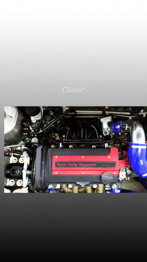

QUOTE(Post-Je-Ape-Ape @ Jan 3 2021, 07:07 PM)
No pressure wash at all. Just take your time.
What I did was
1) Wipe down with damp cloth all over, remove as much dirt n grime as possible.
2) Go over again but this time with dishwash soap. Same technique, wipe wipe wipe. Take your time, and hard to reach places can use toothbrush.
3) Wait dry.
4) Spray tire wax / interior trim wax on plastic cover and rubber hoses and buff with a clean dry cloth. Try to get as many hoses as possible. More hoses = more shinier.
5) Open your engine bay and let your friends jealous. Done.
I'm not a car enthusiasts... Sometimes pop the hood let friend see.. Malu... But not until your level la.. Your one use tongue jilat also not scared
