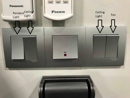

Dear Sifus, need some advice here.
I have 2 electrical points in my dining hall, 1 for fan and 1 for downlight.
Similarly there are 2 points in my dry kitchen, 1 for pendant light and 1 for downlight.
Both areas are located next to each other.

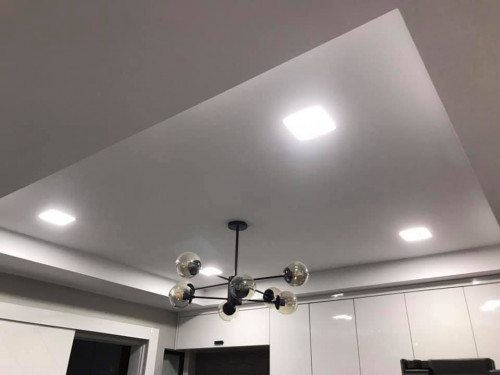

At times, I find that the downlight is too bright (18w each). Can I change the downlight switch into dimmer to control the lighting power?
Thank you.
