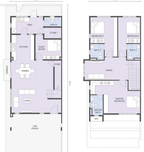

I realized the wall specifications for my double storey landed house is a combination of RC + brickwork + precast panels. When I look at the progress pictures, it seems like most of the walls on the ground floor are precast panels. This kinda throws off my plans to extend kitchens / bedrooms.
1) How do I know if a prefab/precast concrete wall is load bearing or not?
2) How do contractors deal with hacking them and how would it differ in terms of cost when compared hacking normal brickwall?
Thanks!

Woops, I forgot to clarify that my house is actually a landed double storey terrace, not actually an apartment. notworthy.gif notworthy.gif
So am looking at scenarios where I might fully extend to the back both storeys, and even demolish some internal walls to make bigger room. icon_idea.gif icon_idea.gif

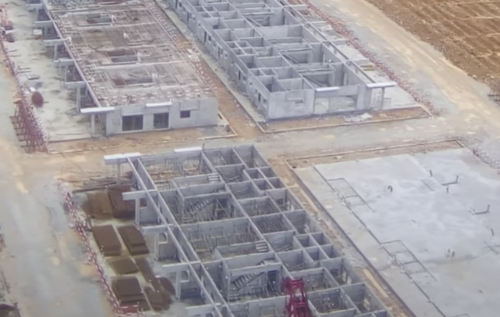

Here's a drone-flyby showing the construction progress (thanks to a fellow resident! https://www.youtube.com/watch?v=8l5lN_J5_ms&t=289s)
I don't see any walls built using bricks on the ground floor, so my worry is that both internal and external walls are using precast concrete. For some of these walls I might need to add new power points, or even demolish them outright for renovation purposes.
From the looks of it, I can't quite distinguish the RC structure - and my worry is that the whole of 1st floor will eventually be supported by both internal and external precast walls of ground floor - which would make all walls of ground floor load bearing = hence cannot be demolished like the typical brick wall (at least not that straightforward).
Just asking here if someone's gone thru the same experience (precast landed house slated for major reno), or anyone with construction experience. On the other hand I've also sent an email to the developer to inquire on walls as well.

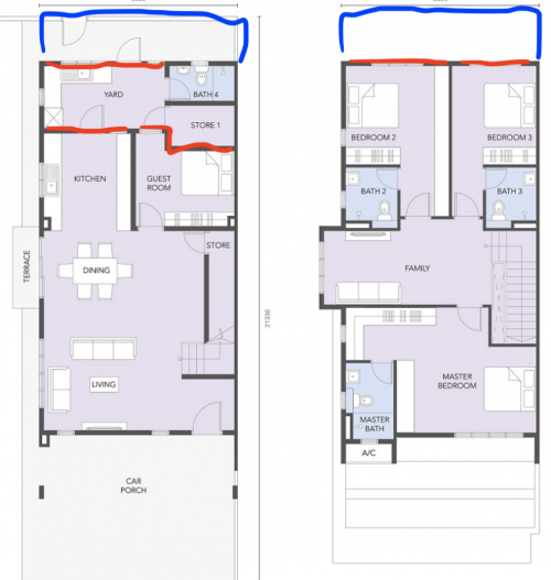

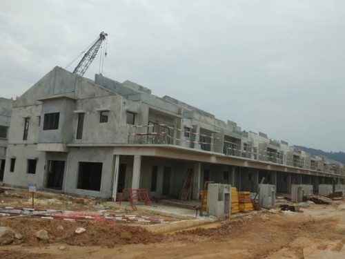

Uh... I need perhaps an architect or a structural engineer to help me...
I'm looking at the floor plan and also the progress photo for my house type, and I'm wondering really if I can extend to the back both stories by tearing down the back walls.
From the progress photo you can see that the walls are prefabricated concrete panels.
So my question is - would there still be the normal skeletal beams + columns for this kind of house that's going to carry the weight?
Or the prefab walls themselves are load bearing - meaning I can't tear them down?

can you indicate which part of wall that you want to hack?
