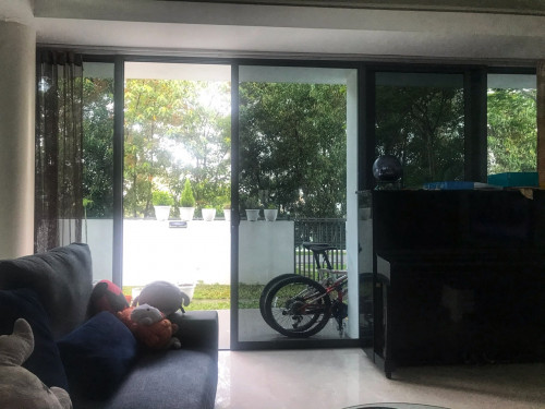

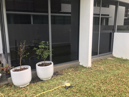

QUOTE(blancpain4470 @ Feb 9 2021, 06:35 AM) During day time where outside is brighter, if you are looking from outside you are not seeing anything inside. You will see a reflection of yourself even though my film is not cheap mirror type. Looking from inside, it is like looking through a light color sunglasses. looks a lot nicer.. it's costly but i think it's good investment if extra budget on hand.. especially nowadays everyone are stay at home most of the time.. a comfortable home is necessaryIn the night where inside is brighter, outside people can see inside clearly. So you still need sheer or curtain for privacy at night. At the same time visibility from inside to outside will be poor if inside is much brighter than outside. You can’t see outside well at all with lights on. The second panel the sliding door is opened so this is the “original” look; the third panel is tinted; the fourth panel is much darker due to TWO tinted sliding doors overlaps. ![]() Outside view. You can see only reflections from outside. ![]() Another view from inside. Very soft light. No more glare. ![]() |

QUOTE(ChuanHong @ Feb 9 2021, 10:14 AM) looks a lot nicer.. it's costly but i think it's good investment if extra budget on hand.. especially nowadays everyone are stay at home most of the time.. a comfortable home is necessary Yes. I have not seen my garden and outside wood/trees until today! To me the business case is to reduce the air conditioning bill but I think the ROI is probably 3 to 4 years! However, the benefits are more than just cooling bill. I listed some benefits here: 1. Reduce room temperature via heat rejection. Thereby saving electricity bill 2. Protect furnishing such as curtains, sofa, photos, piano, etc which are placed near the windows. 3. Easier on eyes as tinting reduces glare. Everything looks softer! 4. More privacy at day time where I can open all curtains and outside people can’t see what is inside. I can also now see the birds perching on the trees in front of my house without opening my door or curtains 😬 On the other hand, the negatives are: 1. It is still expensive 2. If you are looking at this from security standpoint they are not as effective. 3. Performance will degrade over time. So you need to look for one with product and performance warranty for as long as possible - 5 years minimum. Some offers 7 or more years but they will be expensive This post has been edited by blancpain4470: Feb 9 2021, 10:55 AM Bijisss liked this post
