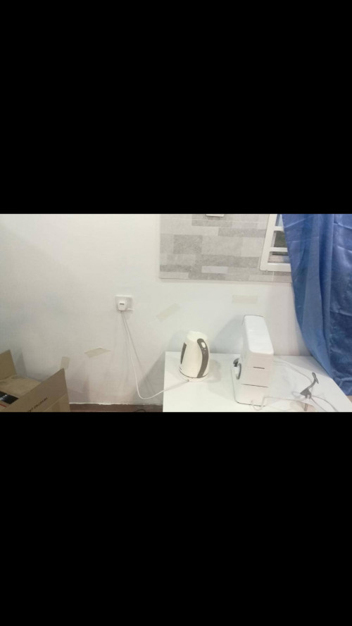

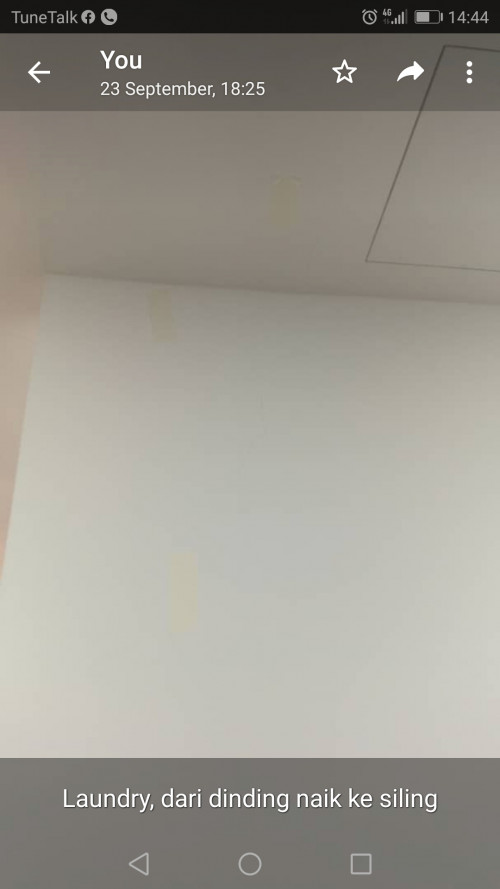

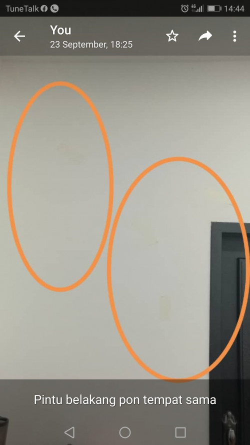

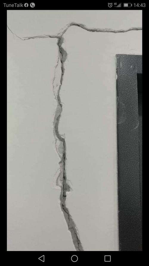

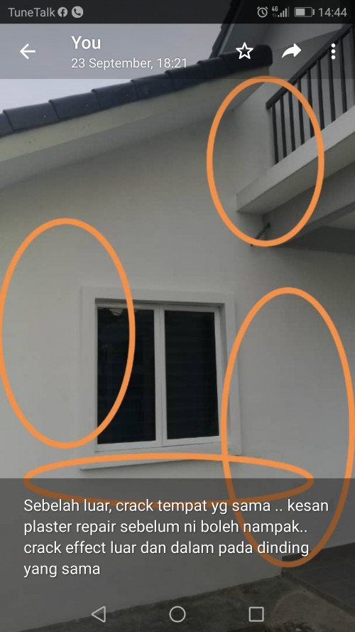

TSpesona3F
post Nov 25 2020, 02:46 PM
133 posts
Joined: Jun 2008
Add picture for references.. there other part affected also but no picture

most of time, this type of cracking is due to the differential settlement of foundations (original and new)

Not much can be done at this stage. Underpinning will likely be too costly and intrusive. Maybe watch out for any neighbours renovation, and talk to them nicely so that they don't put up too much weights on the adjacent area. It could get ugly.

usually any crack less than 2mm width is just cosmetic. Any wider consider structural cracks. Kinda useless if you continue arguing with him
