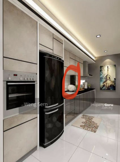

Hi, curious if anyone here knows about the water pipe at condo yard area. Is it not recommended to cover it up and in future it would leak for sure?
Anyone knows what is it used for? For upper floors washing waste or toilet waste?
Reason being is that on certain condo kitchen is too short so will need to extend it to yard area so most of these types of design will then have to use plaster board to close it up so the extended kitchen will not look weird.
Example highlighted in red is the water pipe enclosed through cabinet and plaster board.

QUOTE(adrive @ Nov 22 2020, 07:06 PM)
usually for general washing and washing machine. cover or not cover depends on preference and wealth.

maybe if you can provide a close up to the pipe you mentioned. i initially commented it is used for washing and if you plan to install washing machine. failure rate? 5-10 years. prob less if less used. If concealed pipe fails, and you cannot stand the sight of exposed pipe then you need to spend money. Else you just pull another pipe exposed to where you want it

I think ts is refering to the discharge waste water pipe outlet.
think unlikely as circled in pic is quite high up.
Is a discharge waste pipe from upper floor to the floor below. What is circle is part of it only as the rest are hidden inside the cabinet.
As for ts Q, ...
Seldom will discharge pipe leak unless is poor workmanship in the joints.

thanks that made it clear. the common discharge pipe that goes thru every floor. that rarely fails as it is not pressurised.

I think the best way to cover it up is to build a full height cabinet at that area. And built compartment with door dedicated for that pipe in case of maintenance. It would look better than what was in your photo.
