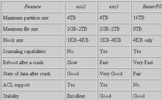

All the filesystems have different pros and cons. You need to choose a filesystem that meets your requirements.

The Pros and cons. You can decide based on that IMO.

State of data after crash ? What is that mean ? Are data become easier to corrupted ? rclxub.gif rclxub.gif rclxub.gif
