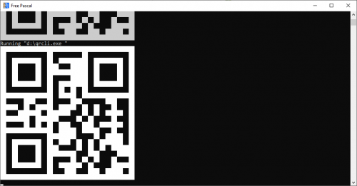

I have created the repo on GitHub: https://github.com/win32app/qrcli
Original output directly from console window which supposed to be scanned and read as "Codemaster LYN", but no, it is not working.
I edited the white background to make it high intensity: (also not working)
Maybe this time someone can help with error correction codes? I cannot find what is example ECC for EC Level = Low (7 bytes) in v1 QR code.
Is this correct?
CODE
 rs_init_gf(285);
 rs_init_code(7,0);
 rs_encode(14,@data[0],@ecc[0]);
 rs_free;
QUOTE
The QR code specification says to use byte-wise modulo 100011101 arithmetic (where 100011101 is a binary number that is equivalent to 285 in decimal).
rs_init_code accept paramaters:
CODE
procedure rs_init_code(nsym: Integer; index: Integer);
So I just set the nsym to 7 chars?
And PByte is pointer to byte array:
CODE
procedure rs_encode(len: Integer; data: PBYTE; res: PBYTE);
Is it okay to set the len to length of string to be encoded, or must include the final 7 bytes of error correction codes as well? i.e. 14 + 7, or just 14 (maximum length accepted by my program)
v1 (21x21) accepts 17 binary chars (regardless of uppercase + lowercase letter , alphanumeric, all symbols)
And EC low is 7 bytes. Masking pattern is every two row (i.e. black = 0, white = 1, then following row black = 1, white = 0, and repeats)
If the data is "Codemaster LYN", the code will generate ECC=196 176 115 55 211 250 0. Is this correct?
Any input is most welcomed!

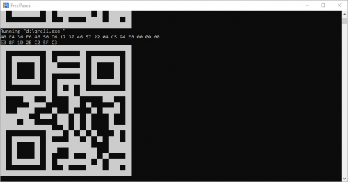

Hey, finally I solved it! This is a decodable QR code. Try to scan.... biggrin.gif
The problem was I forgot to include mode indicator (4-bit) and length of message as part of the data...and my ECC was starts at 1 not 0...finally the ECC should be put in reversed order (6,5,4,3,2,1,0).
Solved!
