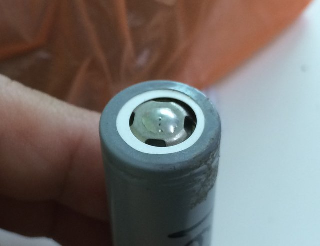

All parts here. Waiting to start back later. Using 18650@12v.
Another reason why I didn't use the welder is because I solder a fuse on the battery. The thin wire hard to weld.

QUOTE(ozak @ Nov 7 2020, 09:27 AM)
18650 cells better use the fuse wire for more safety.
