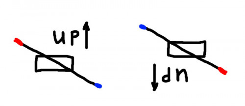

QUOTE(stormer.lyn @ Oct 29 2020, 08:45 PM)
Psst... boss, if you reverse the fan blade, meaning you install it upside down, the slope of the blade IS STILL CORRECT and you will still get downward wind.
Not saying you did, but ....
I followed this , I installed correctly. the sticker with do not remove is pointing towards ceiling, so i can't be wrong in the blade installation...
