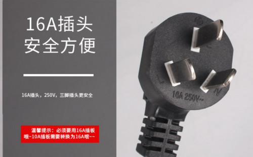

Guys, can I convert this to our 13A UK adapter and use locally? As I am planning to buy a small tea furnace from taobao with 16A adapter. Please advise smile.gif

wait... what is the ampere or wattage of the 'tea furnace'??
its 16A plug. though i doubt it will need so high.

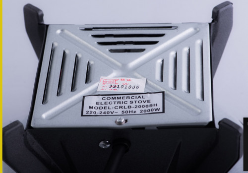

Not much info from the seller page, only this photo about the specs:-

QUOTE(Futura @ Oct 15 2020, 10:09 AM)
2000W is about 8 -9 amps
ya go ahead. its ok. just cut it out and replace with our uk 3pin plug.
you may need to check the color of wire to match. sometimes confusing.

QUOTE(fireballs @ Oct 15 2020, 10:11 AM)
Cannot trust color code of wirings for appliances from China, best is to cut the china plug with a short length of cable and then use multimeter for continuity test to pinpoint the correct cables.

QUOTE(adamw @ Oct 15 2020, 10:37 AM)
actually is malaysia dint follow the international code of color. we still stuck on ryb
even singapore also updated to international.
