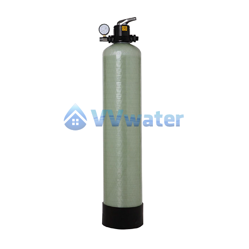

from the filter. I guess already over 3 years. as this filter was brought by my parent and they dont even know need to change the filter sand. The filter looks like below. is it changeable?

ok this one is a sand filter . yes can change the sand in the filter . every 3 years . need to call the service tech to do . in KL will cost about 350 RM to change the sand filter.
the filter system need backwash every 1 to 2 weeks depends on the incoming water quality .
i guess your parents did not do backwash cos dont know about it.
i guess long time not do backwash so much dirt stuck in the sand filter.

lyt25_1234
post Sep 25 2020, 10:07 PM
1,152 posts
Joined: Jul 2011
QUOTE(Momo33 @ Sep 25 2020, 09:03 PM)
I use an automatic timer to turn on backwash.
Much more convinient...don't have to go out and manually turn on the tap to backwash everyday.
Snoy
post Sep 27 2020, 12:14 AM
~SIMPLE~
1,203 posts
QUOTE(lyt25_1234 @ Sep 25 2020, 10:07 PM)
Timer doesn't work on this sand filter.
Yours should be membrane filter.
