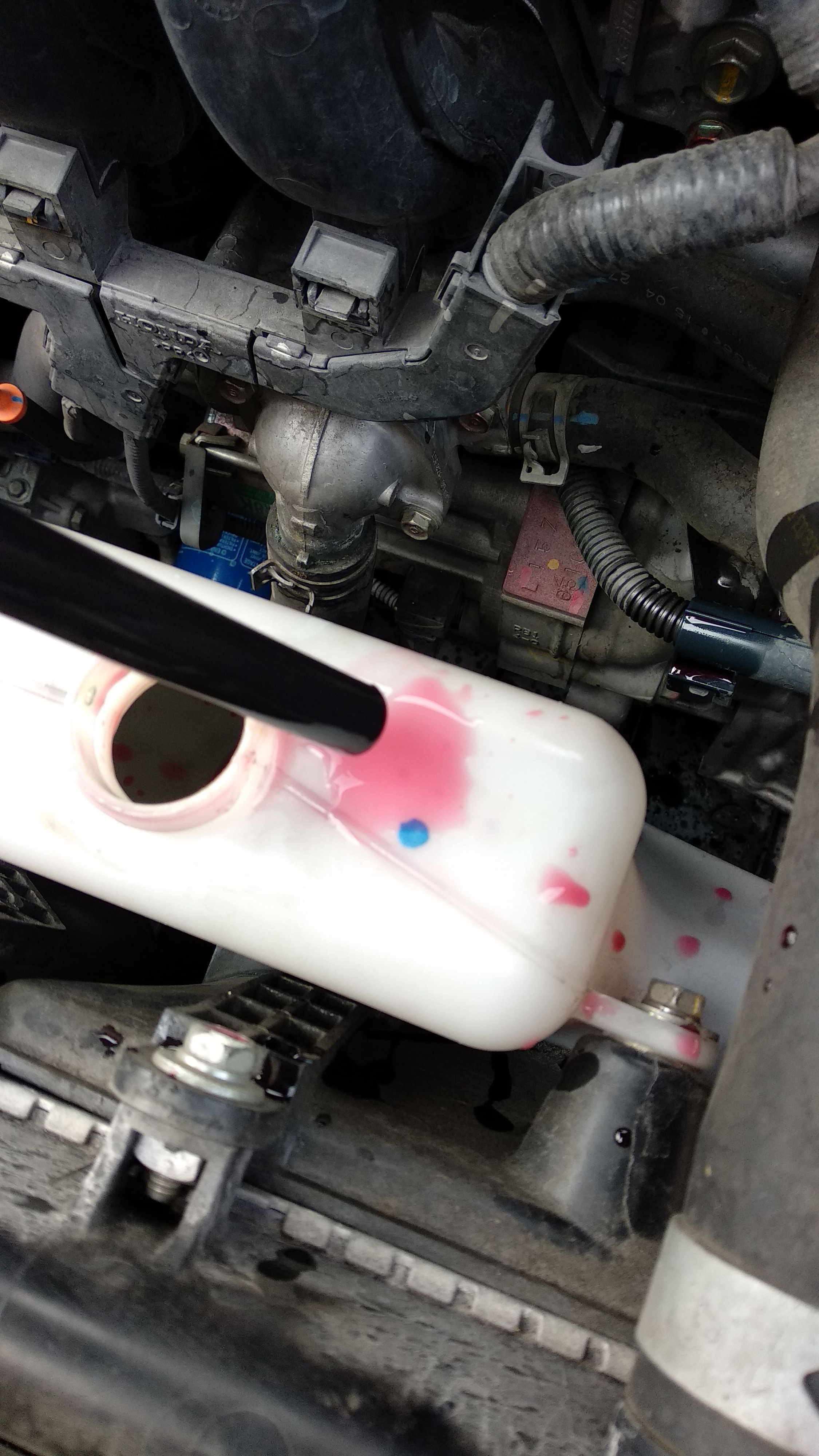

My car is Honda city. Went to an ah Beng workshop and that guy convinced me that all Jap car coolant can be use interchanged. So he sell me this Toyota coolant that is red color and put into my Honda which is originally blue. Not even sure the Toyota coolant is original or not.
Now I worry it will spoil my engine system. So I went to Honda SC at nilai and ask them flush it and refill with original. Not sure the potato understand it correctly or just being lazy? Now my coolant still red in color with a mix of blue-ish.
This post has been edited by exiang: Sep 20 2020, 09:18 AM

Technically, it is the same as both Toyota and Honda uses mainly ethylene glycol based coolant.
The only difference is the colour of their dye. Red vs Blue.
I would say there is no major concern as both are interchangeable but to avoid hassle, I will always stick back to Honda coolant for ease of monitoring the colour of the coolant.
Once you've mixed red with blue, it will be difficult to monitor the colour now unless you do a 100% coolant flush.

ok, drove all the way back to SC and check with the technician again. He did flush the entire system but the tank still got some remaining. They redo it again and now is all blue d.
