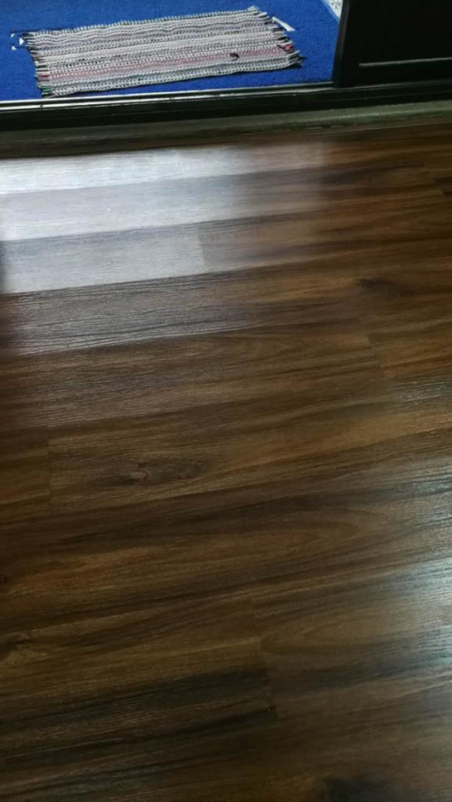

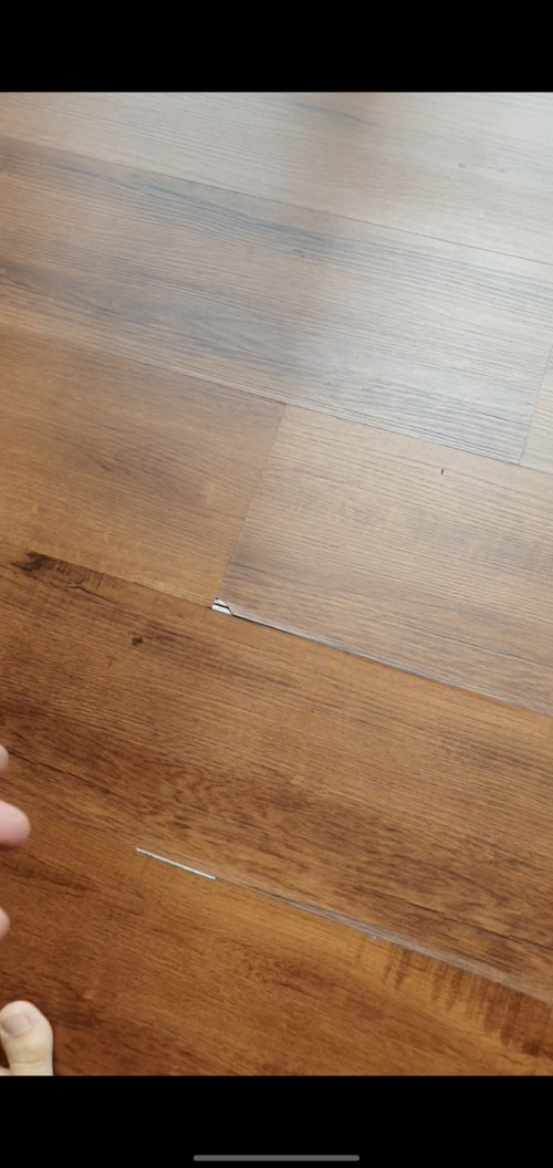

More and more of these SPC have issues. As a flooring seller myself, please check the background of your company and whether they are experienced / sourced the good factories or not. We sell SPC too.
We have received more than 15 enquiries of fixing other brand SPC products until date. icon_question.gif
