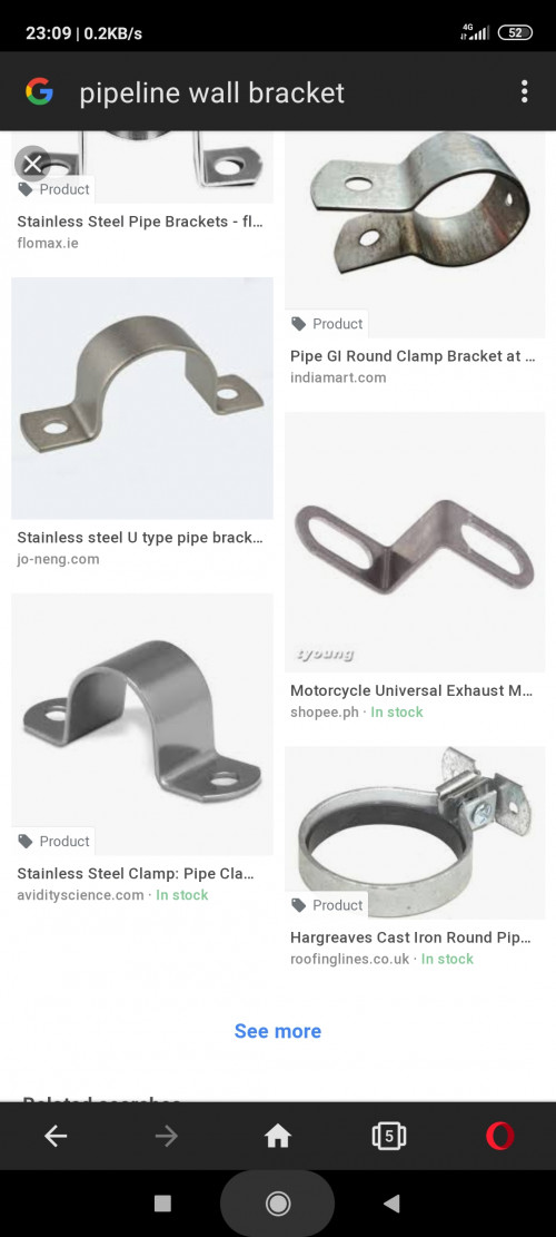

Thanks, that can also do... but I'm looking for something like this
But that is for copper pipe, what about PVC pipe.
My understanding is that I will core through the wall for the usual 1/2' pipe but I am not sure how do I secure them.

TScdspins
post Sep 12 2020, 08:31 AM
2,714 posts
QUOTE(Noryume @ Sep 11 2020, 11:11 PM)
Like this also can. Hardware shop mostly have it.
Thank you, but this mean I have to use elbow joint to bend the pipe 90 degree to secure it to wall and then bend back 90 degree to attach the tap. A bit less elegant but I think currently that is the only solution. thumbsup.gif

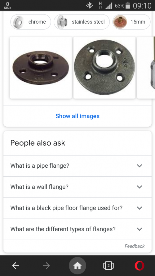

QUOTE(Noryume @ Sep 12 2020, 09:14 AM)
Are you going to drill the wall at the same height you want the tap is it? When I do that I just drill the hole size that will fit the pipe. So it will be secure in the wall. Then apply some filler at the opening. Or you can use something like this.
Yup, it is same height.
I see, these thing is call flanges. Thank you for this info.
I hope the pipe can go through it.
