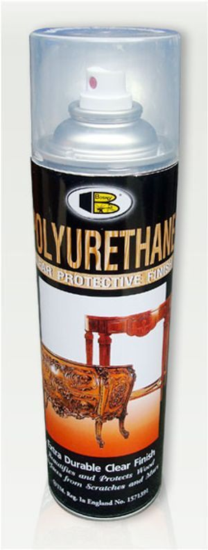

Found this in Shopee, not sure ok or not:
https://shopee.com.my/BOSNY-Polyurethane-Pr...ASABEgLJv_D_BwE

This is what you are looking for.
