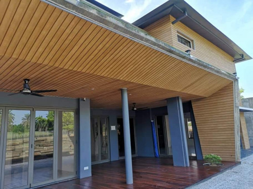

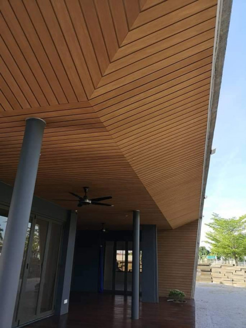

You have several options. PVC, WPC and Timber. Obviously the cheapest will be PVC. Cost depends on site, but I normally charge between 20 to 40/sf. I'm not the cheapest in the market as I am a timber flooring specialist, and we normally do higher end residences and large projects. A general contractor or a plaster ceiling guy might do it for cheaper, so shop around. Just to elaborate further, PVC and timber you will generally use indoors, while the WPC type you will use outdoors, for either ceiling paneling or wall paneling. ![]() ![]() This is our WPC which is Made in Malaysia, and not a china import. This post has been edited by jaycee1: Aug 27 2020, 12:09 PM ahmadkhairil liked this post

QUOTE(fun_feng @ Sep 1 2020, 10:19 PM) Not to say if it is inferior or superior. They are different products.PVC is indoor use only. they dont have the heat, dimensional stability and UV resistance of WPC. WPC is heavier duty and made with the same materials and durability as external WPC decking. They feel more solid and heavy weight. PVC is fine indoors and does have its own benefits, such as lighter weight. Important if you are going to be ceiling mounted, any plaster ceiling contractor can install them without too much issues. Due to the heavier weight of WPC, your support structures need to be more robust to carry the extra weight so there is also additional cost implications there as well, along with the more expensive WPC panels. This post has been edited by jaycee1: Sep 2 2020, 10:42 AM |
