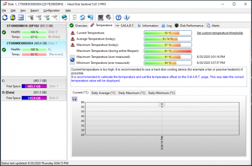

Hey guys, i'm using Crucial MX500 M.2 SSD at my Asrock B450M Pro4. The location for M.2 slot at the mobo is below of the GPU and i notice the temperature is a bit high. Here the temperature recorded using hard disk sentinel :
is it ok for the temperature to be in that range?

Normal temp. Nothing to worry about

u can try to get a heatsink for it..

i try to find in shopee, mostly it is shipped from overseas

this one got 5 years warranty, should not be worry right?

Maybe you can add a heatsink to dissipate the heat better
https://www.lazada.com.my/products/m2-heats...BaCStL&search=1
also, additional fans to exhaust the heat from GPU helps too.

Try remove the PC case side cover and see the temps. Might be airflow problem in your case.

Normal, can attach aluminium cooler fins as well to it.

Idle 55c is ok. But I worried on the max temperature. Most manufacturer recommend max temp is 70 something. Try do something intensive like copy 100GB files to the SSD and see what is the highest temp jump.
Get a heatsink for better cooling, but since it's below GPU you must see how many mm clearance you have for the heatsink.

My Samsung 960 Pro 512GB can hit 70C with M.2 heatsink. Nothing to worry about.

I think the throttle limit for these drives are 75 to 80C
You're good to go.
