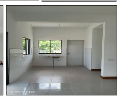

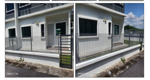

After that, I contact several house inspection companies to get quotation. Price given range from RM 400 to 1k+. Some use Qlassic standard (more expensive)
7.12.2019
- I choose House Defect Inspection (HDI) from facebook. They charge RM 400 and send 2 people to check the house. Report given in 1 week.
You Can see the Report Below
Impression : Ok lah, the cheapest and make my job easier.

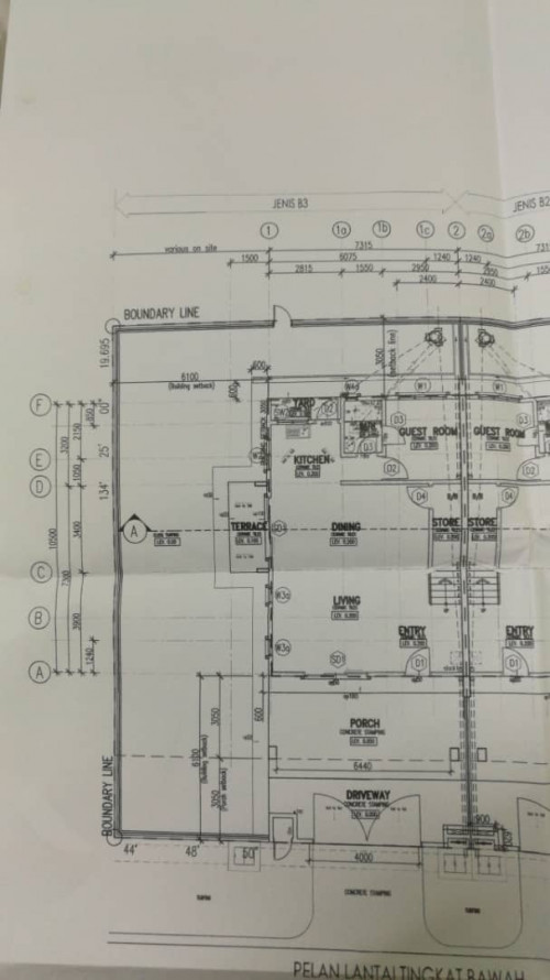

- send letter to PKNS to get the detail house layout (VERY Detail)

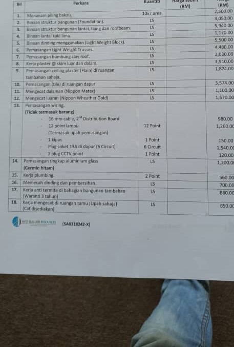

Quotation for renovation

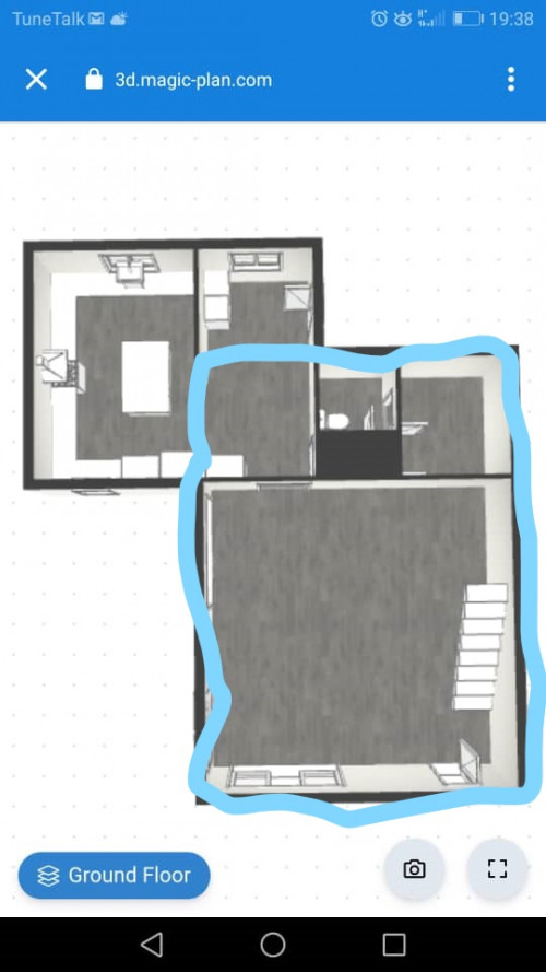

- Job scope : extend kitchen to the back and left (original size around 9x9 to 22x 18)
- Quotation given from 44k to 70k (higher price for Indo)
- Final quotation can be seen below
Original Kitchen Area :
Plan for extension :
Quotation given :

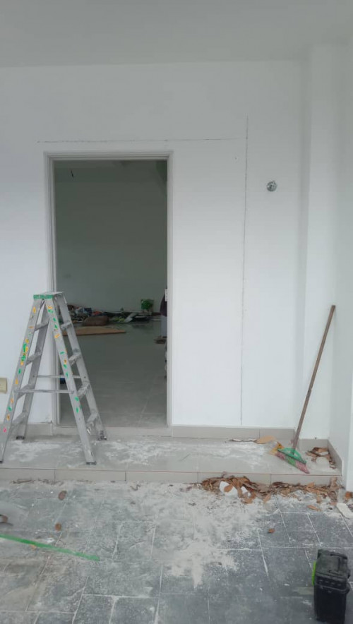

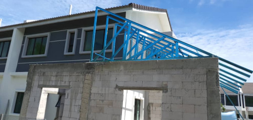

June 2020 --> Renovation continued

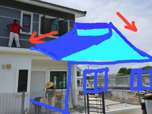

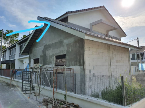

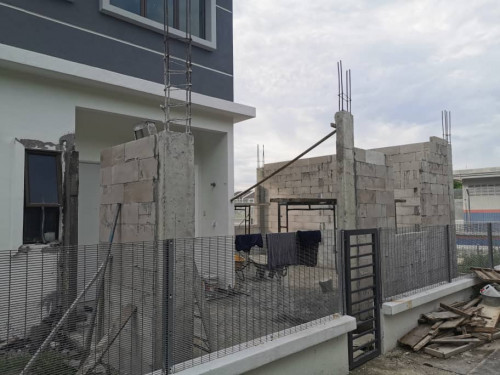

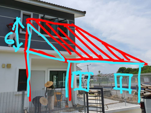

Issue with the roof, contractor said they need certain degree if want to use genting roof. If not, water may enter through the roof and cause leakage inside the roof (long term).
Need to choose 2 design but both need to hack window at 2nd floor
Other option was using zinc type. This one no need specific degree.
At last we choose the genting type WITH additional cost.
You can see the final product here

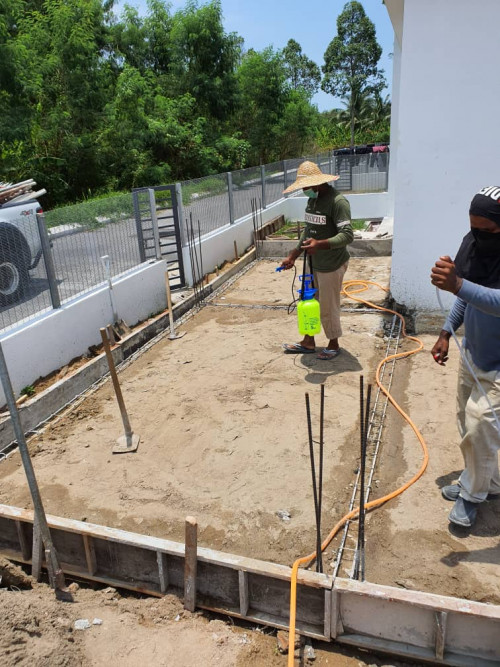

As you can see, they use some big block (light weight block). According to the contractor, due to the weight, it can prevent the house from "mendap" when compared to normal block (more heavy). Not sure true or not.
And the worker said, if use this type of block, the job became easier and faster

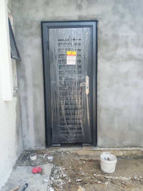

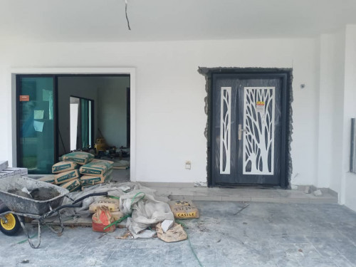

Install Security Door
We survey several security door company. Top is the cheapest compared to other brand like THC or red rhino. We ask PKNS contractor to install front door since they know original code of the tile. And cheaper compared to my current contractor
This post has been edited by pesona3F: Aug 12 2020, 01:06 AM

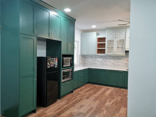

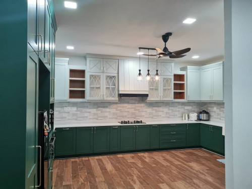

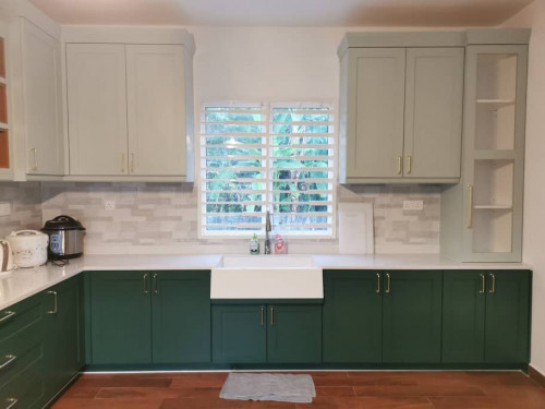

Kitchen cabinet done
This post has been edited by pesona3F: Oct 23 2020, 12:26 PM

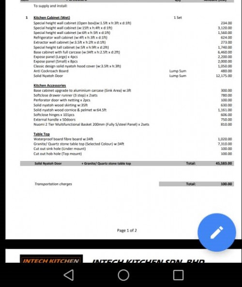

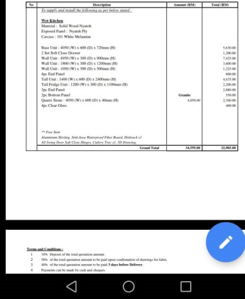

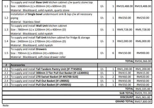

kitchen cabinet quotation
Sink type : Farmsink Granite
Hood And HOb : Not Yet Decide
From Cubix
BALI Kitchen -- > RM 44000 (W/o accessories , plywood/nyatoh)
Hafiz Kitchen Cabinet (Instagram) -- > rm42500 (W/o accessories , plywood/nyatoh)
Cabinet Studio (Instagram) --> RM 67000 (W/o accessories , melamine/nyatoh)
Lora Kitchen
Intech Kitchen
This post has been edited by pesona3F: Aug 12 2020, 06:34 PM

post Aug 12 2020, 08:02 AM
10k Club
14,511 posts
Joined: Sep 2017
QUOTE(pesona3F @ Aug 11 2020, 09:29 PM)
Installing wall cabinets will be a challenged with this type of wall.
TSpesona3F
post Aug 12 2020, 08:33 AM
133 posts
Joined: Jun 2008
QUOTE(mini orchard @ Aug 12 2020, 08:02 AM)
Owh, idk that
Can u elaborate more?
mini orchard
post Aug 12 2020, 08:41 AM
10k Club
14,511 posts
Joined: Sep 2017
QUOTE(pesona3F @ Aug 12 2020, 08:33 AM)
Owh, idk that
When installing cabinets, it need solid wall for anchoring purpose to hold the cabinet.
TSpesona3F
post Aug 12 2020, 09:01 AM
133 posts
Joined: Jun 2008
QUOTE(mini orchard @ Aug 12 2020, 08:41 AM)
I see
I hope no issue will rise later
But i confirm with main con regarding this matter and he said no problem to install kc ( initially i ask him to do the kc but later change my mind)
Kc con also visited the site and i already inform him regarding the block and he said no issue

QUOTE(pesona3F @ Aug 12 2020, 09:01 AM)
I see
Issues wont be immediate. It is over the period of usage when it tends to loosen.
There is one part of my bedroom wall where the curtain rods can hold long after changing few positions and is the workmanship problem where there is not enough cement being used in between bricks.
This post has been edited by mini orchard: Aug 12 2020, 09:43 AM
