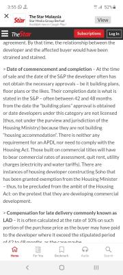

Iprop
Even here Lawyer's site
This is one of the latest updates. That's why I am confused with some of the SPAs with the 48/54 months etc time frame. Does it not mean that any extension given by the same person/the KPKT is now invalid? rclxub.gif confused.gif

developer apply for extension AFTER launching. in some cases developer got the extension and try to force it upon the purchasers. it was challenged by the purchasers and the purchasers successfully won their case. an go google.
https://www.theedgemarkets.com/article/cour...na-condo-buyers
back to scenario 1, there are cases currently being reviewed on legality of extension in the first place. some are of the opinion that a schedule g or h shall not be modified in any circumstances and thus any extension is deemed invalid irregardless. if the developer needs more time, they can do a headstart and sell later. but of course without revenue of purchaser, cost will just continue to go up with these new trend of super tall highrises that cannot be completed in 36 months.
so from conclusion, scenario 2 can be challenged and scenario 1 is still valid for the time being.
