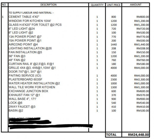

 800sqf condo renov cost 36k, is it reasonable?, not sure market price
TSdiudiusing
post Jul 3 2020, 09:19 PM, updated 6y ago
29 posts
Joined: Oct 2012
attached my 800 condo renovation fee, i not sure whether this price worth it or not, 1st time buy house and do renovation, i think this supplier markup a lot T.T

Lol. You didnt cancel the top bank and account number and name.. xD But it seems quite fair priced. Where is your location btw?

You bnalnk the bottom name but leave the top page. Exposed already.
I guess that is the price in KL, though it looks expensive for me. The contractor did list breakdown resonalby well.

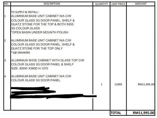

kitchen cabinet material can change to melamine with solid surface if want it to be cheaper..
the rest seems not far off, since you are hiring contractor...

IMO i think its not bad, also depends on what his floor is.. haha.. condo sure got a lot of rules and regulations to follow.. xD

this come with interior design ? all in one that type

my minimum is quartz

paying expensive for wallpapers design

Wow but fair price.

Betul! Unless really no budget, then choose a white solid surface... still better than laminate top.
The most cost effective way is actually to use concrete top, however it takes more time and hassle to build one. Quartz etc is for aesthetic/modern kitchen and it comes in modular unit.
Really biang if use solid surface over long term.

My comments: if u wanna safe, can buy the ceiling fan online or at Puchong shop. For Lighting, Fan, water heater installation, i go to electrician who charged much cheaper than the contractor. Water heater also can buy online. LED light, all sizes, go to Puchong for the best price.
For grill i know one contractor who charge much less and she already installed for 2 of my houses. Can pm me her details

painting 4k is a bit expensive, unless they help you patch the wall

water heater installation 50 bucks per unit je WTF 1k .....
Give indo include ceiling max pun 500 je .

maybe supply and install price la. but if installation 1k per two units, I also want to change job liao
Maybe it is storage water heater that TS is using? It should be around that price for storage water heater.
