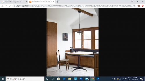

I want to create this sort of aesthetic so I need a carpenter to be able to do such cabinets. Don't know whether I can find or not
It shouldn't be a issue.
There are many ways to construct something like this.
But if you want the real feeling of Classical Zen, it will increase the cost and QC of workmanship need to be good. mega_shok.gif
This post has been edited by LynxAssn: Jul 2 2020, 11:13 PM
