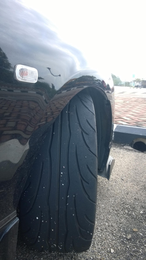

Anyone drive around daily with semi slick tires? How was it?
Example potenze re003
Hankook v720
Accelera 651 sport.
Today boring boring go hunt for tires. Ingat want to change to potenza re003. Mana tahu my tire size dont have pulak..195/50/16.
I cant go up to 205 because it will rub my fenders (now already roll fender, so now cun cun only).
I cant go down to size 15 where there are a lot more tire sizes because my brake caliper too big..minimum need 16 inch rims with positive offset..
Only tires ngam my car is the accelera 651 sport. But this brand macam not so famous.
Dilemma betul aiii...
Add on another tire which suits me. Sumaxx max drifting Z1. Threadwear 180, copypaste AD08R design.
So long d haven't choose buy my tires. But tomorrow i will be going out to buy a set.
Showdown between accelera 651, sumaxx Z1 and toyo tr1.
This post has been edited by Balanced: Jan 18 2021, 09:15 PM

Is the accelera 651 sport (pic in my 1st post) a uhp or semi slick tire?
drewn123
post Jun 13 2020, 03:32 PM
101 posts
Joined: May 2010
QUOTE(Balanced @ Jun 13 2020, 03:17 PM)
Quoted from the official website;-
The Race Tire
The 651 Sport is Accelera’s street legal race compound tire with a semi-slick tread. With two main ribs, a water film breaker, and three directional grooves, the 651 Sport is engineered for precise handling and quick steering response, both on and off the track. The 651 Sport comes in both 100 treadwear and 200 treadwear, making it perfect for drift and track applications. It’s versatility also makes the 651 Sport a good choice for limited daily driving needs.
Somewhat same as using AD08 as daily use, dry condition very syok. You cannot expect much from these tires in wet condition. My suggestion if u really wanna try semi-slick out is JUST DO IT... Heck, i used AD07 and AD08 on my daily ride before but just go REAL SLOW on wet or raining days... really slow <50km/h on straight and even slower on corners when wet. biggrin.gif biggrin.gif
Furthermore the thread wear on semi-slick is around 180-200, so it'll finish fast and change back to all season UHP tires then. As long as you know the limitations and disciplined with your right foot.

QUOTE(Balanced @ Jun 13 2020, 12:54 AM)
Hankook v720
Accelera 651 sport.
This post has been edited by blaze_spirit: Jun 13 2020, 07:27 PM

QUOTE(blaze_spirit @ Jun 13 2020, 07:26 PM)
I dunno mang. The shop tire guy told me one. So these tires can use as daily?
