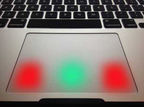

Questions: My touchpad are un-clickable on the red areas(no click sound responding when you press), green zone are still clickable(respondable) when you click the touchpad. It also quite tough to use two finger to select and drag the text currently,
Would it be
1.Battery bloated?
2. Dust caused?
3. Machine sudah tua, tak boleh guna lagi, need parts replacement?
Please advise.
Thanks.

If it is hard, stiff, apply more strength before you get a click. It is most likely due to swollen battery. FYI there are only one physical click button at where you marked green. Clicking too far at the edge might not register the click. If it is not due to swollen battery, a service and adjustment to the trackpad mechanism will usually solve the issue.
I will not wait if there is a swollen battery inside the unit.
My previous experience are 3 sides(left, middle, right) of them having same click feedback, it had become 'clickable' on the middle during MCO.
not sure it's battery issue, but it could possible also as already 7years 365 days usage.

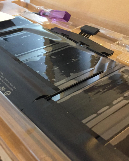

Newly bought battery

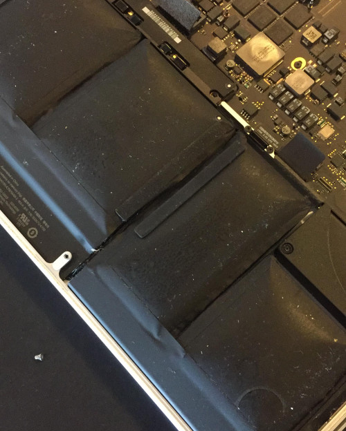

Bloated battery
damit the my cover has bend a bit due to the bloated
ASAP change the battery
like new now
