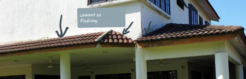

Hello helllo! May I get some advise from fellow forumers and sifus
I'm planning to redo roof tiles on a 30 year old subsale double storey semi-D (vacant currently till reno done). Major renovation 8-10 years ago. BU 4k sf.
Previous owner roofing was not done properly with the GF roofing not having any flashing (cemented to the wall) and the damage of the leaking at the patio ceiling is obvious.
There is also ZERO gutters.
The initial 3 options I thought were :
Option 1 : Most expensive (I guess) is to redo the whole roof – replace truss and tiles
Fortunately the contractor who has inspected said the current wood truss is still in good condition. Thank god, can save some $$$ on truss
Option 2: Replace damaged tiles + flashing + Repaint / Respray (not sure if roof tiles can respray?)
The ID company I’m in discussion with mentioned they do not provide nor recommend painting the roof as they mentioned it can cause the roof tiles mechanism to be disrupted (not sure how), causing leaks? Is this true? I’m thinking option 2 would be the most cost effective
Option 3: Retile the whole roof (maintain existing wood truss) + flashing
Need some advise from sifus here on :
1. Is gutter for the whole roof really necessary? As the perimeter is very long, I’m considering only doing gutters at where the water splash maybe significant and to cut down some cost
2. Looks like it’s only option 2 and 3. I was quoted a massive RM50k for option 3 (sorry, I don’t have the total area yet, will ask my contractor):
To dismantle, dispose, and supply labour and raw materials to build new roofing included:
i Fascia board
ii Roof Gutter & down pipe
iii Concrete roof tiles (monier elabana) and necessary fitting
3. No mention of insulation in the quote. Is it possible to install insulation if I keep existing truss? If yes, what would be ideal (mid range budget) for concrete tiles + wood truss?
Thanks in advance for any advise!

Go for Option 3 + proper insulation, peace of mind for another 20 years. Anyway, RM50K is a bit on the high side. I presume your house is around 3000 sq feet?
My advice is to install gutter and proper rainwater discharge for the whole roof. Not only there's no splashing when rainwater hits ground, it prevents any damage it might caused.
For roofing works, I advice you to get a proper or specialised in roofing contractor. Looks simple but not. A good roofing works can prevent a lot of future unnecessary damage (leaking, small animal walking on your ceiling, etc)
