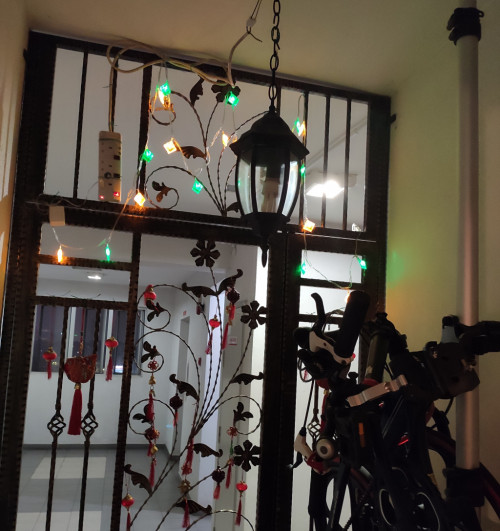

Hari raya puasa is just around the corner. Ayam not muslim, but to cheer anyone passing my condo unit I decided to put on the lip lap LED lights in front of my main entrance door. People all are concerned about covid 19 (including me), so I feel I want everybody to be happy happy.
There is existing electric cable for front light already (connected directly to a pendant lamp). So I decided to detach the pendant light first, then do simple wiring as shown in the illustration, safe or not? Note the cable from the ceiling only got live and neutral.
1. First get an extension cable and cabut the plug
2. Connect live wire to live wire, neutral to neutral, but ground (from the extension cable) left hanging.
3. Connect lampu lip lap to extension cable
Safe or not eh? Please gib advice.
I know the proper way is to convert the cable from the ceiling into an electrical socket, but I don't feel like drilling holes and bother the tenants here during weekend. Maybe will do it myself after MCO and all.
Note:
1. I don't want to be that person who burn down the condo building just right before raya.
2. Also donwan to be fried by electricity and susahkan orang kena pandu ambulance.
Update:
Done liao.
Actually I cannot find which one is live and neutral wire from the ceiling. My voltage tester macam rosak, dua dua wires show ada current, WTF.
But since the 2 pin plug any direction pun boleh, I hentam je sambung wires from the ceiling to the extension cable. Switch it on for 1 hour and no panas, should be okay I think.
Only after pasang the lights did I realise macam not meriah since the lights are too few lol, should buy another 1 to sambung. Anyway better than nothing, looks nice when lip lap actually.

Done liao.

Oh mai gosh
Somehow seeing both green ketupat & red tanglung (apologies if its not xP) in 1 picture makes my heart go Fuwa Fuwa wub.gif

QUOTE(billylks @ May 17 2020, 01:28 AM)
Done liao.
Should self DIY with power supply, Node MCU and 5m Ws2812 led string for more power.

QUOTE(pergilahsayang @ May 17 2020, 01:51 AM)
Oh mai gosh
The red tanglungs are from chinese new year, lazy to take them down, lol.
I also put up christmas decoration during christmas.
Just that deepavali I don't know what to put. Want to draw kolam I think only girls draw it.

QUOTE(Fubar20 @ May 17 2020, 01:54 AM)
Wei okay lah liddat, not that sad if see the lights in lip lap action.
I got better one at my balcony, that one a lot of LED and super bright.
